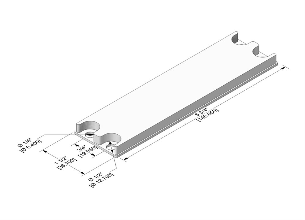

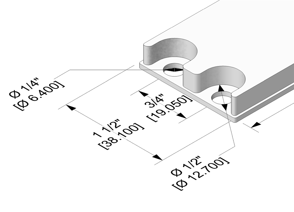

I had an old SELCAL unit that was in pieces, so it become my doner. I will have to make the unit's aluminum backplate 5 3/4" wide and will be .375" x 3 which is 1.125" in height. the .375" is center to center of a Dzus rail1, 2.  After which I will print the front plate with the proper clearances for the two Dzus fasteners on each side. There are 3 lights: HF Com #1, HF Com #2, and SATCOM Msg, and they will be driven by three relays. There are also 2 volume controls, Audio, and Tone. The Arduino Mega will also provide the audio tones. and the two-volume controls are potentiometers, the Arduino will give up 2 of its analog inputs for measuring the voltage of the pots.

  • beacon_dave
    beacon_dave over 3 years ago in reply to phoenixcomm
    I've PM'd you some files of the 3D model for you to test importing.
  • phoenixcomm
    phoenixcomm over 3 years ago in reply to beacon_dave
    Dave, you are great! Can you supply me with a dfx so I can import it?

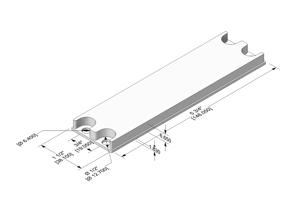

  • beacon_dave
    Extruded heights adjusted to 6.65mm & 1.83mm
  • phoenixcomm
    Thanks for the help, Dave, Cover ~ 6.65mm.  Backplate (aluminum) 13ga ~1.83mm
  • beacon_dave
    Any closer?
    What material thickness are you using, imperial 1/16" backplate and 1/4" front panel as shown here or the metric 1.5mm and 6mm?
    Or something else?
