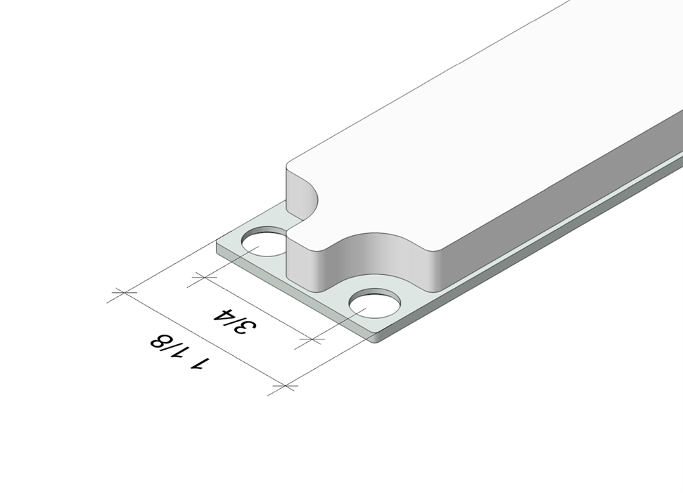

I had an old SELCAL unit that was in pieces, so it become my doner. I will have to make the unit's aluminum backplate 5 3/4" wide and will be .375" x 3 which is 1.125" in height. the .375" is center to center of a Dzus rail1, 2.  After which I will print the front plate with the proper clearances for the two Dzus fasteners on each side. There are 3 lights: HF Com #1, HF Com #2, and SATCOM Msg, and they will be driven by three relays. There are also 2 volume controls, Audio, and Tone. The Arduino Mega will also provide the audio tones. and the two-volume controls are potentiometers, the Arduino will give up 2 of its analog inputs for measuring the voltage of the pots.
The lamps are 23 mm x 11mm and they mount by the use of a sleeve behind the panel they were made by Ducommun part number 30288RBS1-2.

    Would a base model to import into TinkerCAD help any?
    I couldn't see any photos of 3 Dzus unit high SELCAL units online, most are 4 Dzus units high.
    From what you describe and the attached resources above, I ended up with something like this:
    which may be completely wrong... Slight smile
    I started out with AutoCAD (2D) v2.0 when it fitted on a single floppy disk. It's changed a little bit since then.
    However, most of the above can be done in 2D layers with a final extrude to 3D.

    I'm wrong. the unit should be 38.10.mm high and the holes from edge to center are 9.525mm. To fit I will need the equivalent of 3 diameters in the center + 2  1/2 for the plate edge. where the aluminum backplate holes are 6.4mm.
  • beacon_dave
    beacon_dave over 3 years ago in reply to phoenixcomm
    Any closer?
    What material thickness are you using, imperial 1/16" backplate and 1/4" front panel as shown here or the metric 1.5mm and 6mm?
    Or something else?
  • phoenixcomm
    phoenixcomm over 3 years ago in reply to beacon_dave
    Thanks for the help, Dave, Cover ~ 6.65mm.  Backplate (aluminum) 13ga ~1.83mm
  • beacon_dave
    Extruded heights adjusted to 6.65mm & 1.83mm

    Dave, you are great! Can you supply me with a dfx so I can import it?
  • beacon_dave
    I've PM'd you some files of the 3D model for you to test importing.
