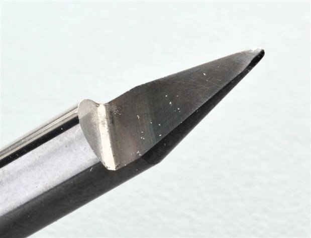

    So I've been playing with my CNC (600 x 600 x 75mm height) and finding out more about dealing with plastic.
    They recommend a single flute cutter with a reasonable feed speed so the chips get removed and it reduces heat build-up in the material.
    ChipX are making a few at reasonable prices and this is apparently excellent https://chipx.co.nz/shop/cutting-tools/chipx-tools/router-bits/cm025-025-1f-30dg-58/
    It used to be sharp and pointed until someone added a piece of aluminium and forgot to reset the Z axis (4mm v 0.25mm is NOT the same)
    I'm sure you could knock up something similar for a dremel.
    The control board is based on a Smoothie design and their own drivers as the Stepper motor driver chip market is getting tight (too many 3D printers being made)
    Don't underestimate the rigidity required, you don;t want it flexing when moving in the X or Y direction.
