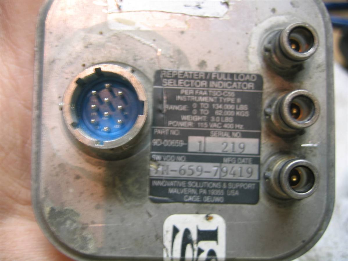

Manufacture Part Number Miss
Parker Hannifin 219-100-001
Innovative Solutions 9D-00659-1 SW 7H-659-79419
Manufacture & Part Numbers
Table 1

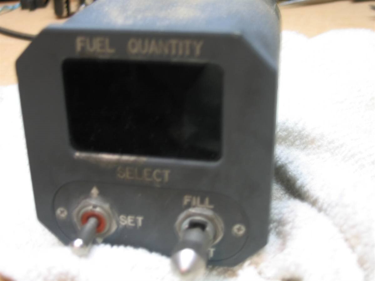

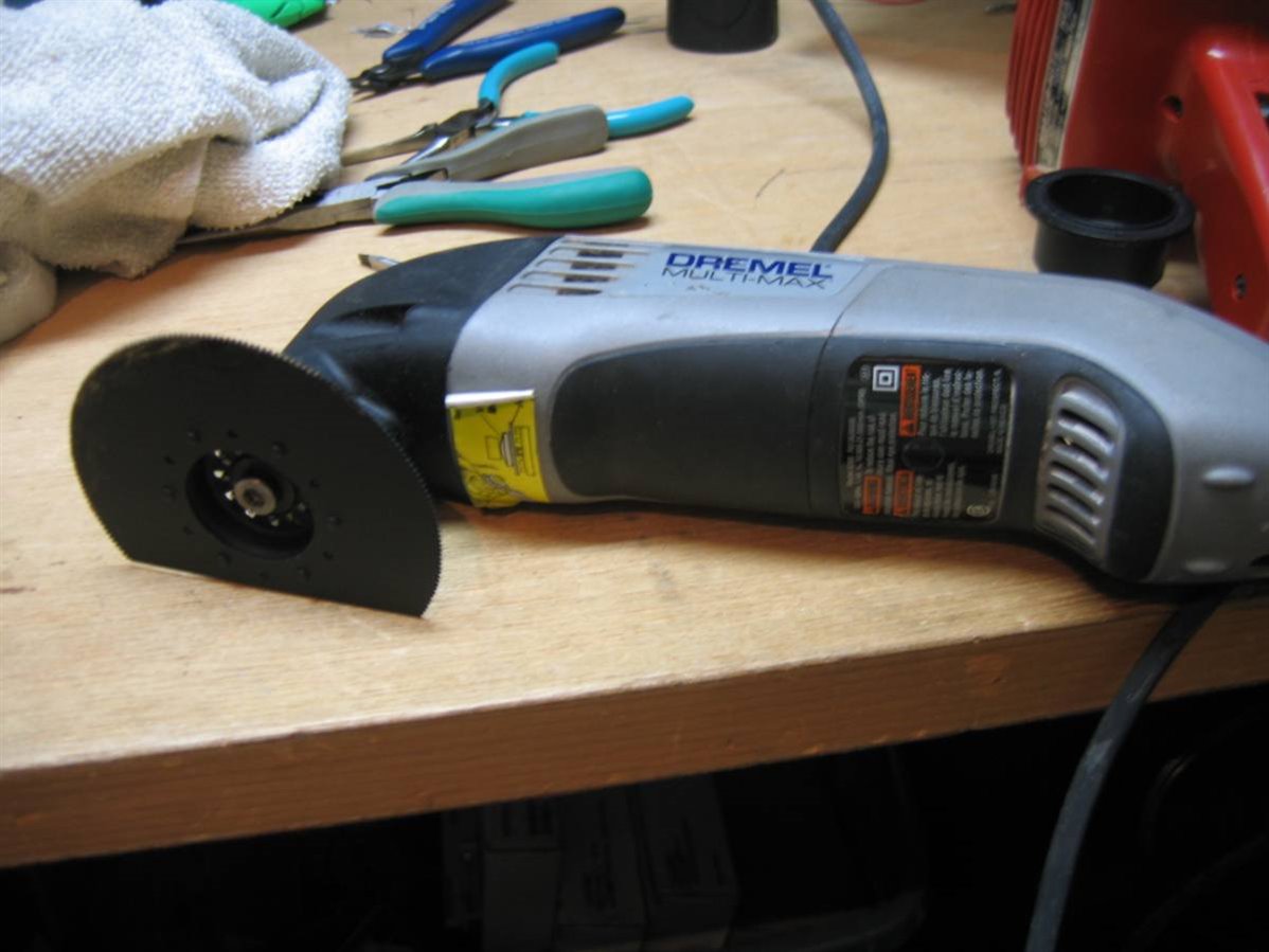

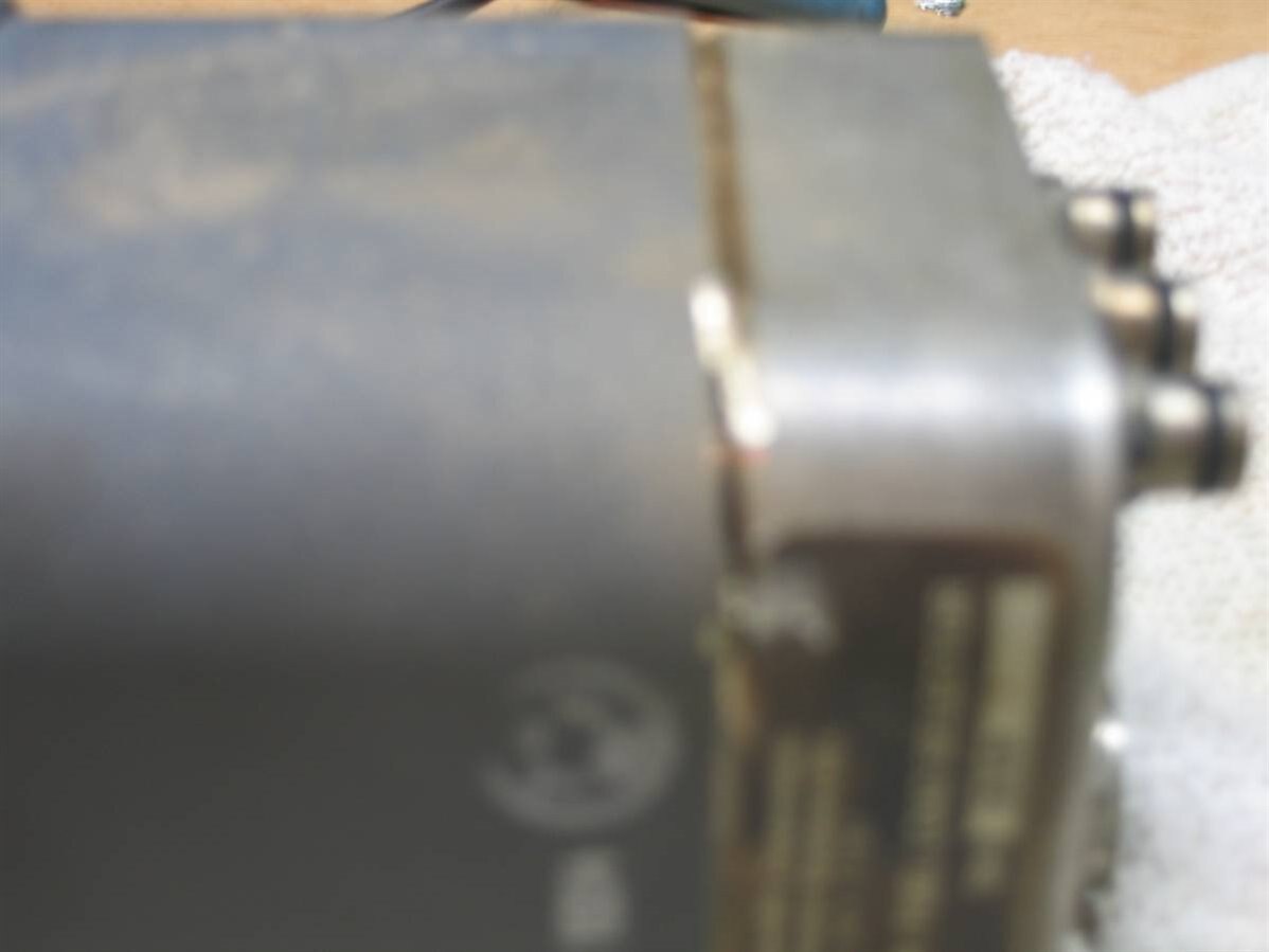

imageI have had this Fuel Quantity Indicator  (Figure 1) for about 6 months or so. I have been stonewalled by ISI from getting any info. During Cockpit-Fest it was suggested that I cut the unit apart. Well, this unit is solder sealed and I don't have a fire ring.. So out came my Multi-Max (Figure 8) and put a metal blade on it.. well it took about an hour to get it apart and it's not pretty, but the job is done.

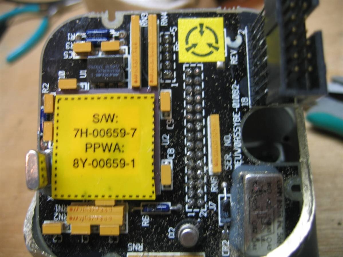

Well first by the numbers (see Table 1): Parker Hannifin made the unit. for Innovative Solutions got it and well good luck. In the bottom there is a PGA85 (Pin Grid Array) and I took off the label, and the part is a  5M-00497-1 which is a private label, and a date code of 9416.  More Work!

  • The back ie Power Supply (Figure 4): Has an LM-109 5vdc regulator + a bridge and some caps.
  • The middle ie Logic Board (Figure 5): Has a large EE??? part and a MAX690MJA microprocessor supervisor

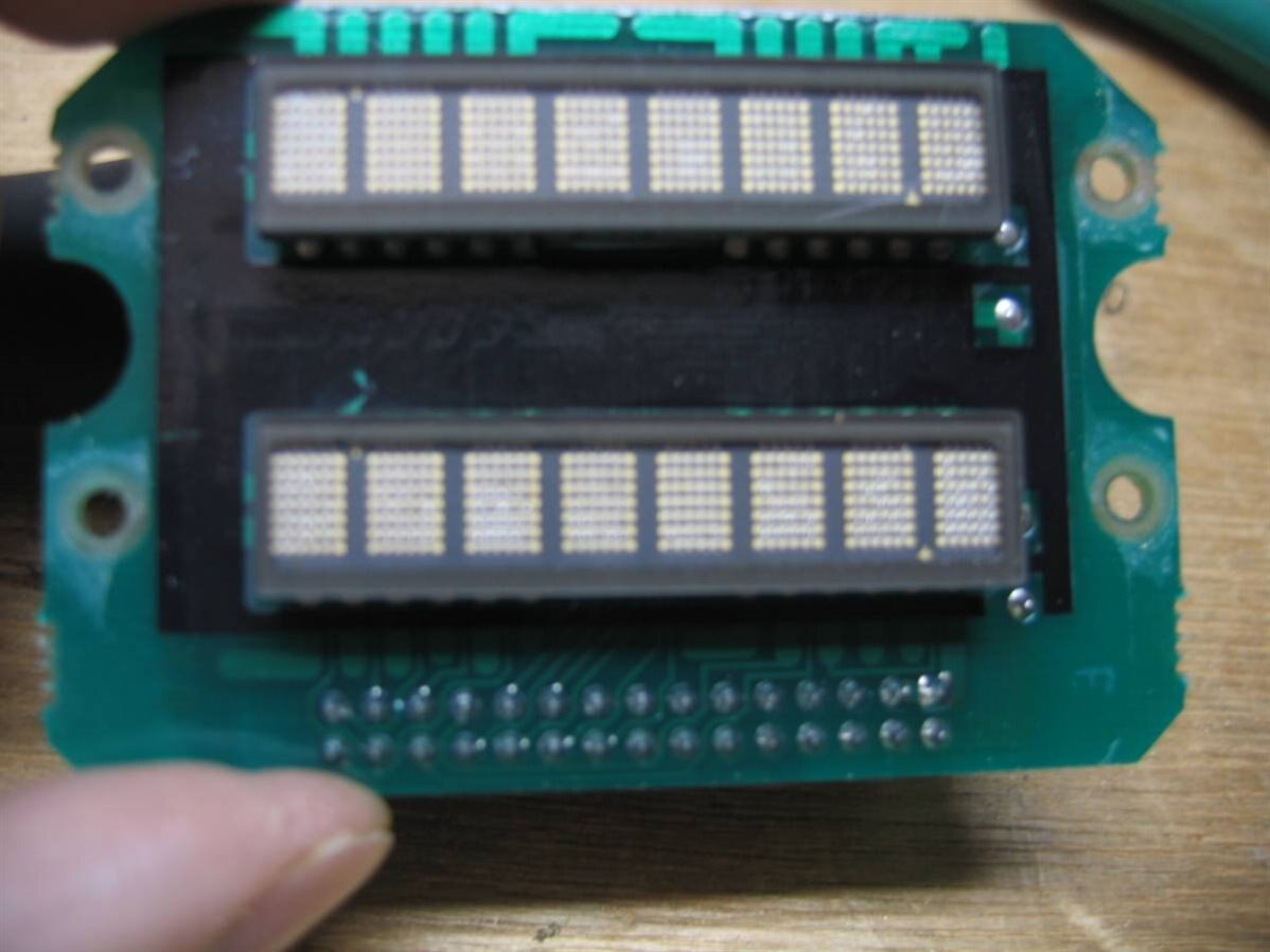

  • The front ie the Display Board (Figure 6): Has two (2) HDSP-2131TXV  each display has 8 chars 5mm high of 5 x 7 chars each and has a 30 pin head connector.

UPDATE:  shabaz  informed me that IC manufactures sometimes put the part number in the silicon.... and he was right..
Our Mystery part is a Motorola MC68HC711  which is a MC68HC11 with a security feature..

    Dab, I just called ISS and I spoke to a person in "Customer Service" he said:"The only information he has on the unit is the ATP, and its against policy to send out of the company".. but I asked him about the tri-ax connectors which I thought were 1553 but could not find the hardware upon opening the unit he confirmed they were inputs from the tank sensors (capacitive). At the end he said that he will send me the ATP..:)
