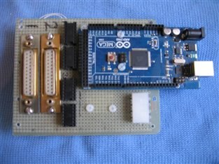

THE PLAN (Step 2):  Well the first thing we need is a piece of Vector Board, about 4" x 4"  or about 10 x 10 cm ( Do not buy any cheap crap off of ebay.. It must be FR-4, glass-epoxy ).
Vector Board before for clean up
Figure 1
I need cut 2 holes in the board about  2" x .5" (Figure 1), or you can use a DB25 punch if you are lucky enough to own one, $$$$.  I cut the two holes with my Dremel multi-tool, but it is very hard to control, I now have to clean it up, anyway, with my Dremel. If I had the right blade for the rotary tool it would have been easier. Then I need to mount the adapter plate(s)(Figure 2) to the Vector Board and the DB25(s) to them as well.
The next thing is to mount the three 16 pin IC sockets, a little dab of hot glue, or crazy glue and that should do it. But remember to leave room for the 4 pin Molex connector that is common on disk drives, and fans, Molex Part Number image
15-24-4441, Molex Specification Sheet, and a relay that control the panel lamps.

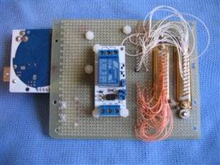

I  really like this relay module I found on eBay (Figure 3) and the cool part is I don't have to build it. There is all so a 2 channel module as well. BTW they are cheaper than I can build them..lol
Now the only this to do is break out the Wire Wrap stuff and wire it up (Figure 4).
image  Keep Tuned In, More To Come
~~ Cris H.
BTW Long to finish got sick anyway just finished now on to the next part.
I am having the adapter plates made for me. Let me know if you think you can use them. I might get a small run of 100 made. My guess is they will be about 5 to 8 bucks each.
1 Channel Isolated 5V Relay Module
Figure 3
Interface board finished *
* The power connector, nor is the relay wired in yet..
Figure 4
                                                                                                                                                                                                                                                                                                                                                                  One more note: I have found some food containers used in the food business NR2402P-BLK my interface bolts right in. Oh yes the white dots in the photos in figure 4 are nylon 4-40 screws and nuts. image
