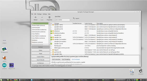

Screen Shot of Synaptic Package Monitor
Figure 2
OK let's start in your arduino directory and we will install the arduino-1.6.2-linux64.tar.xz as arduino/arduino-1.62.
Now go to your eclipse-avr directory and will install the eclipse-cpp-mars-R-linux-gtk-x86_64.tar.gz as eclipse/eclipse
If you haven't executed the command to get the GNU-AVR toolchain, then do so now.  Now is a good time to check for the JAVA Runtime 6. If you have 7 you don't need 6 (Figure 2).

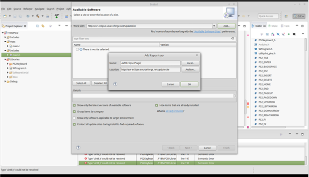

Ok, now we have to launch eclipse, click on the eclipse icon in your Tools/eclipse-avr/eclipse/ directory. It will ask you for you default workspace (say yes), you can always change it. DO NOT CHECK THE BOX "Use this as the default and do not ask again." Now the eclipse IDE will launch.  So let's add the AVR plugin. Go to: Help > Install New Software. A new window called Install will open. Near the top is a drop-down box with "work with:" to it's left. Click the box and type http://avr-eclipse.sourceforge.net/updatesite/ then click add. In the pop-up box that appears type AVR Eclipse Plugin into the "name" box (Figure 3).
Screen Shot of eclipse Install/Add Repository
Figure 3

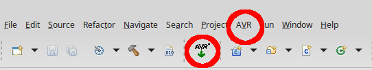

Now Please restart your eclipse IDE File > Restart. When eclipse restarts  your eclipse IDE should now look like this (Figure 4):
AVR plug-in installed
Figure 4
