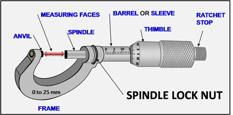

This is a really nice find at my local pawn shop. I uncovered this jewel in the Dollar box.  It was sticking badly. It really needed a good cleaning. It was a Starrett model 436-1.  I retracted the spindle into the sleeve and then removing it. by continuingly rotating the thimble counter-clockwise. This took a few tries but finally separated it.  I used a lightweight oil and a new Scotch-BriteRegistered Stainless Steel Scrubbing Pad to clean the spindle. I had to repeatably fully insert and remove the spindle from the barrel. You could use a piece of printer paper with lightweight oil to then polish the spindle.imageimage
Spindle & SleeveBurn Mark on SpindleFins -- Good Enough
The micrometer now runs in and out smoothly. It is off .001" but I need a special wrench to set it back to 0.000". The micrometer is missing the ratchet stop (it's jammed), and the spindle lock nut is non-functional at the moment.

    Looks like it had a very hard life ... No micrometer should be subjected to that sort of abuse .... There's a good writeup here. Evaluate, Repair and Adjust a Second-Hand Micrometer You should be able…

    mark your right I found the article at the Instructables after I had taken it apart. At the moment how can I say it is good enough. And with it closing on 1. I know that I have to subtract .001" from the reading but what the hell. We used to say "It's not quite specced but in spec." LOL
