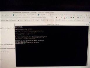

Well, I'm not done yet. I might be down. I need some more stuff for this project so off to Micro Center. And about 130 miles later. I started over from scratch here is what I did:
* Please note: this information has come from two sources
  • https://elinux.org/Beagleboard:BeagleBoneBlack_Debian#Flashing_eMMC
  • BeagleBone AI Survival Guide V3.11: PWM
I downloaded a new image from Debian to my computer.
  1. copied to my 64 Gb Flash with a DD command.
  2. In /boot/uEnv.txt:  Edit this Line FROM #cmdline=init=/opt/scripts/tools/eMMC/init-eMMC-flasher-v3.sh  TO cmdline=init=/opt/scripts/tools/eMMC/init-eMMC-flasher-v3.sh
    1. Install flash on to BB AI
    2. Then Reboot ⏎
    3. Lots of stuff on the screen at it updates the onboard flash
    4. Remove my flash
    5. Then Reboot ⏎
  3. edited in the network address from WiFi to Wired
  4. sudo apt-get update ⏎
  5. sudo apt-get upgrade ⏎
Now take a deep breath an have another Scotch.
  1. sudo apt install -y ti-tidl mjpg-streamer-opencv-python ⏎
  2. cd /usr/local/sbin ⏎
  3. sudo wget -N https://raw.githubusercontent.com/mvduin/bbb-pin-utils/bbai-experimental/show-pins ⏎
  4. sudo chmod a+x show-pins ⏎
  5. cd /opt/scripts ⏎
  6. git pull ⏎
  7. sudo tools/update_kernel.sh ⏎
It's now after midnight. So it seems that I am back where I started.
