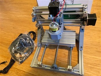

I was lucky enough to win a shopping cart prize earlier this year in the Arduino contest, and element14 was nice enough to send me this lovely little CNC machine:
Here is the link to it, by PCDuino: http://canada.newark.com/pcduino/108302018/cnc-engraver-assembled/dp/33AC0136
Sadly, I see it is no longer being manufactured. And I can't find any other cnc machines in this size or price range here. I do see you can get many just like them off eBay for similar pricing though. Some (lots of!) assembly required.
Thankfully the one from element14/Newark was fully assembled - I just had to tighten a few screws and bolts.
It's a small unit, the bed is 18cm x 10cm, but that's perfect for me to do most of the little things I've been wanting to try out.
Plus that size is much more convenient for storage and use.
And it fits nicely on my desk while I figure out how to get started!

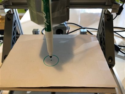

First things first: testing with a marker and paper.
I don't want a mess in my office, or the noise, or the extreme danger factor that comes with fast spinning sharp things near my cats - so I didn't install the router bit and I keep the router turned off, and I taped a marker to it instead.
The choice of marker is a really nice starting point for technical reasons too. It's quite forgiving as to the vertical position, a little bit lower just means a bigger line. And as I found out the hard way already, when I really screwed up the vertical position it just kinda squishes the marker tip but no real damage done.
The unit came with a power supply and a usb cable. I only just had to plug it in for power and into my MacBook. That part was easy.
First steps - I installed UGSPlatform for Mac (I'll try to get more detailed later when I have time), and promptly found it wasn't recognizing my CNC machine. sigh.
Turns out for Mac, with this particular type of controller, it needs to use a different serial library, which can be selected in settings (in UGSPlatform).
Then having finally connected the unit, I played around with the buttons on UGSPlatform for a while, to move the CNC machine around in all 3 dimensions. This also tests the limits and it tests to make sure that the unit was built squarely enough to not hang up anywhere in the work area. All that worked nicely and I didn't have to change the hardware at all (kudos to the assemblers at PCDuino!). Do keep in mind that the hardware and software do not have any stop sensors built on, so if you try to go beyond the end it will make some awful noises. Step slowly and carefully.
After being satisfied that the unit was working well in general, I grabbed "circle.gcode" as a test file (I forget where I got that. somewhere on github...), and after setting x,y,z to the proper starting positions, I drew a circle!

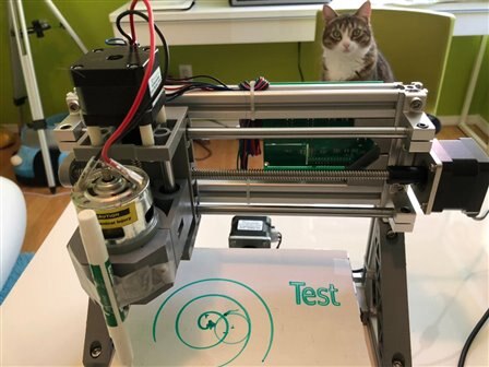

After that worked nicely I thought I'd try with text. Because I'm not very original I just typed "Test" image  I realized later that I should've typed "Cat" image
And here is the result (see picture). That messy bit in the center is where I had the Z (vertical) axis set wrong and it shoved the marker into the paper like a smoker snuffing a cigarette with much gusto.
Notice my manager looking on image
