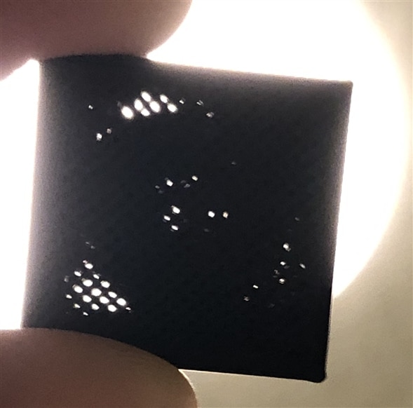

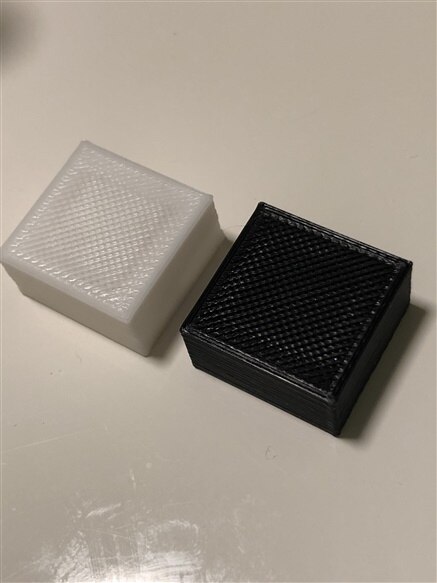

    The sides look great, but for top and bottom It looks like it's under-extruding, so I have tweaking to do. However, the Creality white PLA is also under-extruding, even though I used the supplied Creality PLA settings for that. Even the sides on the white one are showing gaps.
    They only take about 15 minutes to print, so that should help me run through the tests a bit quicker.

    The top and bottom problem could be due to unlevelled bed. I faced similar issue when some part of my print was sticking to the bed but some was slightly lifting up from the bed. You will have to experiment a bit for that.

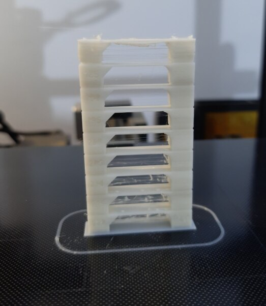

    Also, the settings in the printer are not always correct. It's always a better practice to experiment with the temperature setting for your filament whenever you get a new brand/new filament. I print temperature towers like this one because it gives prints at different temperatures. Each horizontal slab is printed at a temp difference of 5 deg C. Notice the stringing (bottom layers) at higher temperatures and at very low temperature (the top) causes bad prints. However, in the middle part the prints are perfect.
