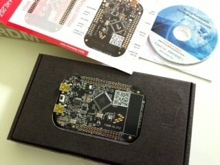

This is the box it came in - neat and tidy, well designed.
And inside the box we find the dev board, a handy reference card, and a tiny CD with some development software that I chose not to use.
As you can see, the CD is not Mac friendly, as my slot-loading Macbook doesn't like little CDs. I'm sure the software could be downloaded, but I don't intend to use it because I'm using mbed.org.
The one thing I wish was included is the headers for all the connections. Without them I was only able to run a few samples that don't require external connections (I didn't want to solder anything temporarily). Still, with the LEDs, touchpad, and accelerometer that's a lot of fun to be had!
