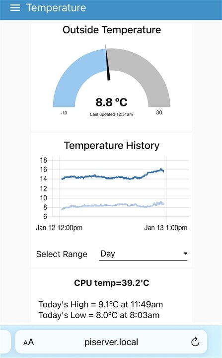

I spent far too much time last night adding daily high and low temperature display to my Raspberry Pi  node red hummingbird feeder monitoring UI.
So many limitations and quirks to work around!
First, Influxdb does not have a “start of day” function, so I had to do that in a node red function. I need that so it doesn’t include yesterday’s readings for today’s highs and lows.
Then, I realized everything is in the UTC timezone, which gives a different meaning to “today”, so I had to adjust that on both ends: in node red AND in the influxdb query.
Things got personal, so I couldn’t quit!
But look! How pretty!
ultimately it was only a few hours, but for that tiny bit of result I was thinking it should have been like 10 minutes! Maybe I need to lower my expectations Joy

    Pretty much, yes! In my case I was thinking that I could do it all in one Influxdb call. What was more frustrating was seeing examples of flux (whatever that is?) doing what I need for the “today()” call, and then later seeing the note about this not being available in Influxdb. Also getting max and min in one call is possible, but then you don’t get the related time stamps. Shrug
