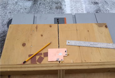

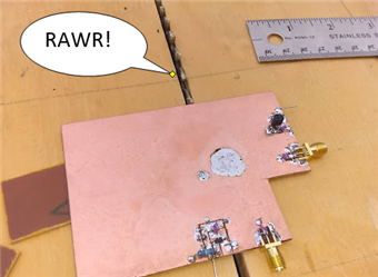

    Low of 8!? Ontario got a cold snap recently, almost froze my paws off trying to chop copper clad Great work as always, thanks for sharing!

    I didn’t know a table saw would work for cutting copper? Looks like you’ve got some cool projects on the go!
