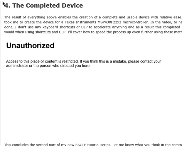

  • geralds
    geralds over 9 years ago in reply to rachaelp
    Hi Rachael,
    In the part 2 also part 3 under the point 4. there are "unauthorized " fields. There is missing the image "completed device".
    Best Regards
    Gerald
  • rachaelp
    rachaelp over 9 years ago in reply to geralds
    Hi Gerald,
    Thanks for pointing this out, I think this will be another issue relating to the forum upgrade. I had this with one of the videos and it turned out to be upgrade related.
    Dudley have you got any idea what might be going on with these images and stopping them being visible?
    Best Regards,
    Rachael

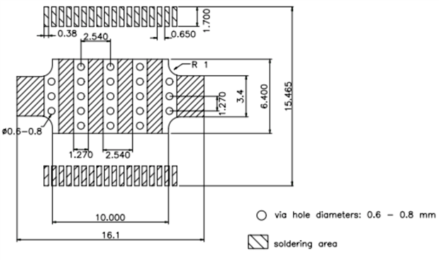

  • rflmota
    rflmota over 9 years ago in reply to rachaelp
    Hi rachaelp, thank you for your feedback! Regarding the footprint I referred, it belongs to STM L6470 driver, but the package itself is proprietary's STM POWERSO-36 and its commonly used in many other motor drivers the company sells. Regarding the design of the footprint itself, my main challenge is to design the polygon for the exposed pad, I've managed to design it by calculating and adjusting manually all the coordinates of the polygon, but I was wondering if there's a more practical method using grids or so. The most challenging for me was to design the rounded corners, I'm not sure if I've done it with the exact radius specified.
    Thank you for your help!
  • rachaelp
    rachaelp over 9 years ago in reply to rflmota
    Hi Ricardo,
    Ok no problem, I will put together a quick example of how I would go about doing this image
    Best Regards,
    Rachael
  • Dudley
    Dudley over 9 years ago in reply to rachaelp
    You find the interesting issues rachaelp image
    I've solved this for those blog posts - all I've done to solve this is to move the video records Creating a device in Autodesk EAGLE & Creating a device in Autodesk EAGLE into a different space. They were originally created in your blog.
    The strange thing is that there is nothing wrong with video records being kept in your blog - I've found other blogs where the video record is kept in the blog and it all works fine. So I don't know what's so special about your blogs - debugging through the permissions code gave me no clues. I've also tried it myself in a hidden space and it's all being created fine.
    So - this is one for me to keep an eye out for. I've setup a watch so I'll get notified about the next couple of blogs that get created with video in, and I'll see what happens.
