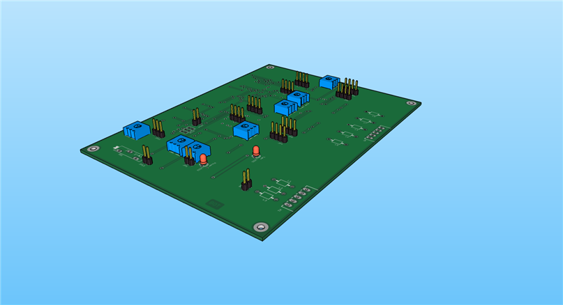

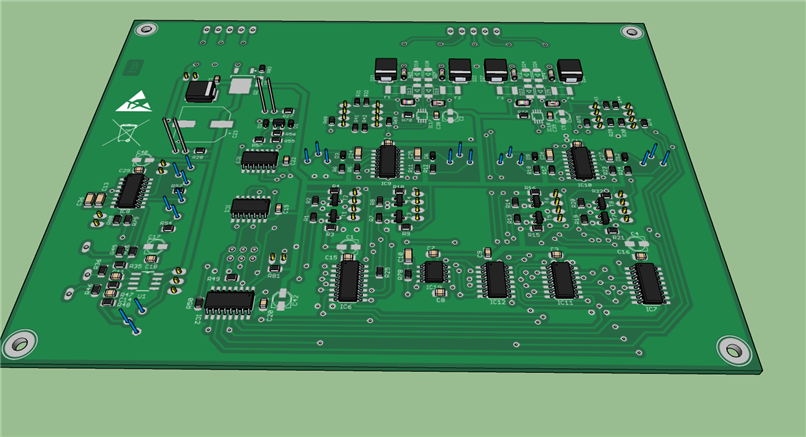

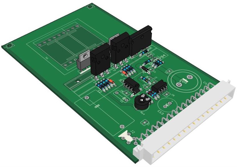

    Hi Rachael!
    Excellent! Thank you very much.
    Actually for 3D viewing I use the ulp eagleup.ulp with the tool Sketchup.
    Here you'll find all, what you need.
    https://eagleup.wordpress.com/
    Interesting, Fusion360, MCAD have an interface to Sketchup.
    https://developer.sketchup.com/en
    I like it, because you can see all in a foto-realistic simulation instead of STEP viewing.
    Some impressions:
    The devices are moveable on the board, so you can easily correct some mistakes.
    I also created a database for the colored devices, e.g. the resistors with its color rings.
    That makes a really cool lookout.
    With this viewing, Sketchup, you can also easy measure the dimensions, or relationship between the mechanical components.
