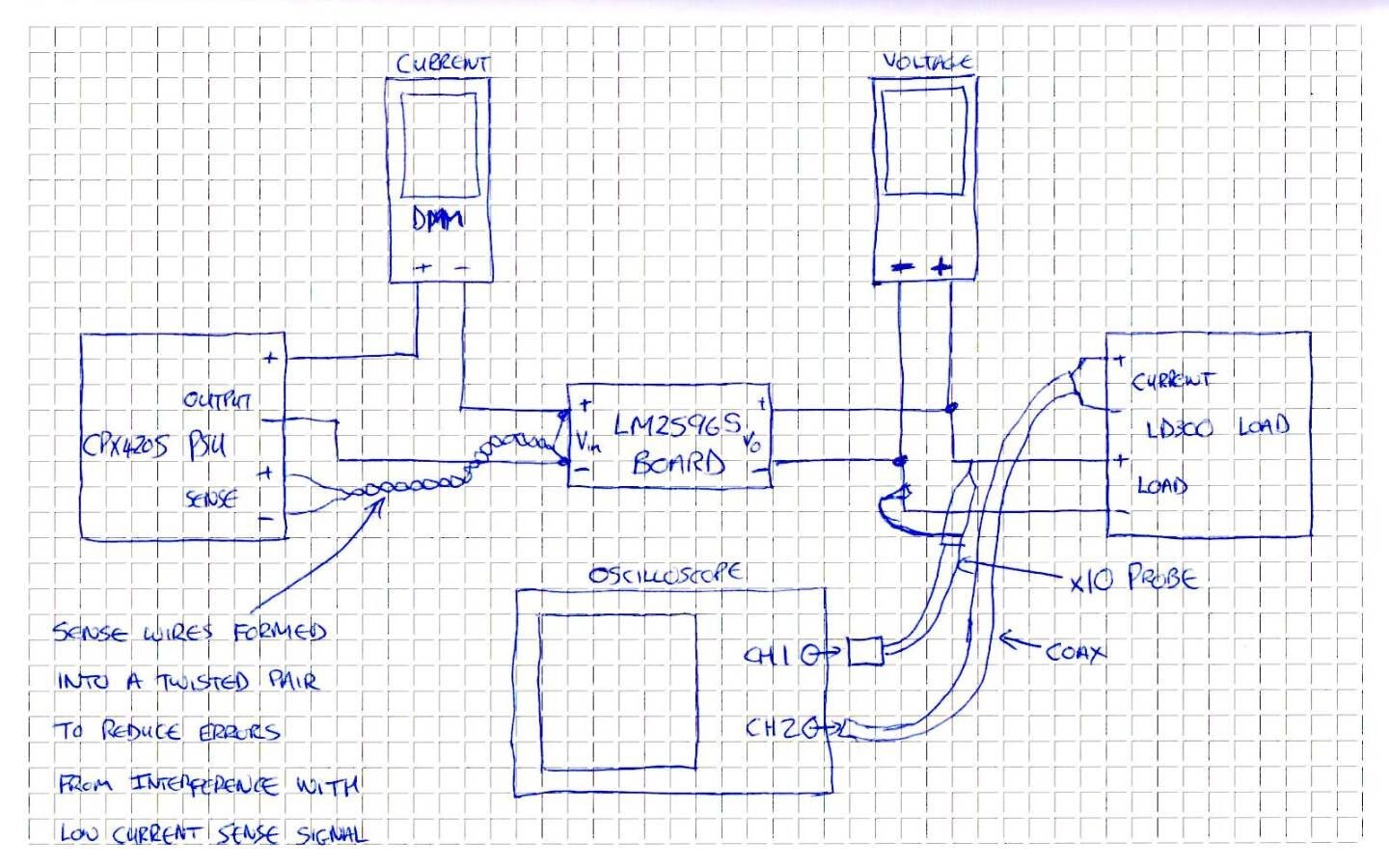

The input of the LM2596S board will be from the TTi  CPX400SCPX400S Power Supply The KeySight U1272AU1272A will be wired in series with the positive input voltage to measure the input current. The remote sense will connect directly at the input of the board such that it will compensate for any losses in the cable and also the burden voltage of the ammeter As stated previously with this compensated supply voltage the input voltage will be read directly from the set voltage on the power supply
The output of the LM2596S board will connect directly to the TTi LD300 DC Electronic Load. The Keithley 2015 THD will be connected directly to the output of the board to measure the voltage at the board output therefore eliminating any losses in the output cables. The current can be read directly from the electronic load.
The Keysight MSO-X 3054A Oscilloscope shall be used to examine the voltage and current waveforms of the LM2596S board. Channel 1 connected directly to the output of the board with a x10 probe. Channel 2 shall connect to the current monitor output of the electronic load by a BNC cable and shall have it's input impedance set to 1MOhm.
The test setup is shown below:
Note: I have drawn the multimeter on the output just connecting in the middle of the output wires. In the actual setup the multimeter is connected directly at the output of the LM2596S board to eliminate voltage drops in the cabling under high current loads.
Now on with the actual testing!

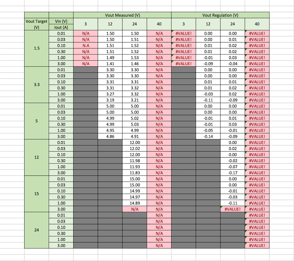

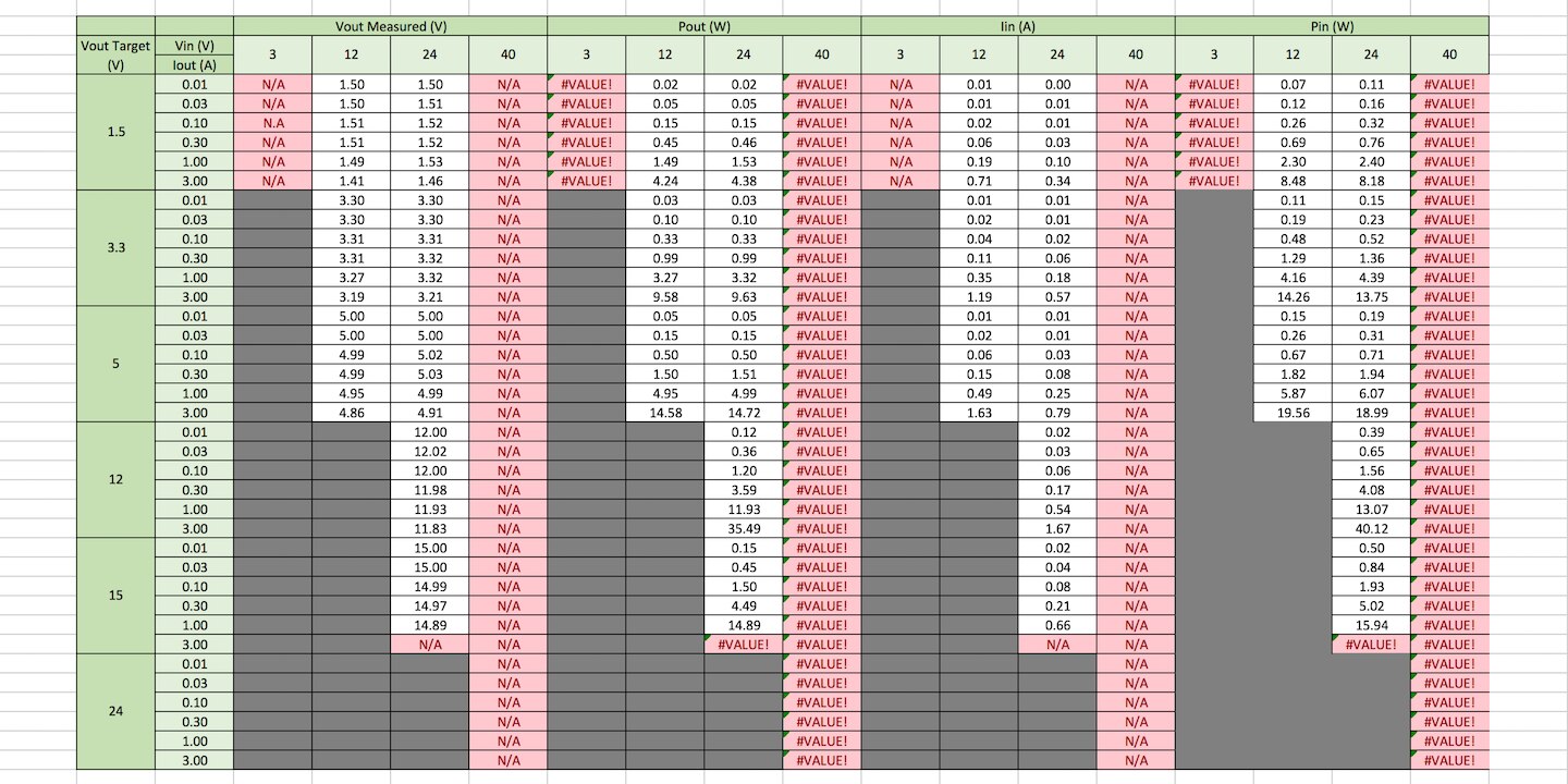

The following table shows the measured input current for each setting of input voltage, (unloaded) output voltage and output current.
There are a few things to note in this measurement data.
Firstly I could get no meaningful output at 3V input even though the spec says it should work. I believe this is down to stability and could be fixed by changing the capacitors and inductors to values and types selected specifically for the lower voltage range.
I was also unable to get the output to hold up with 24V input and 15V output at 3A load. As I increased the load current to about 2.4A it would immediately collapse. It would also collapse at a much lower output current of a little over 1A if I tried to increase the load too quickly. This is a stability issue again.
Finally you will see the 40V input column is blank. As I set up for the measurements and applied the 10mA load the converter board failed an emitted the magic smoke. I believe it came from either the inductor or the voltage setting POT but it's now totally dead. I will take the components off and test them to determine which has failed for this to happen at such a low load.

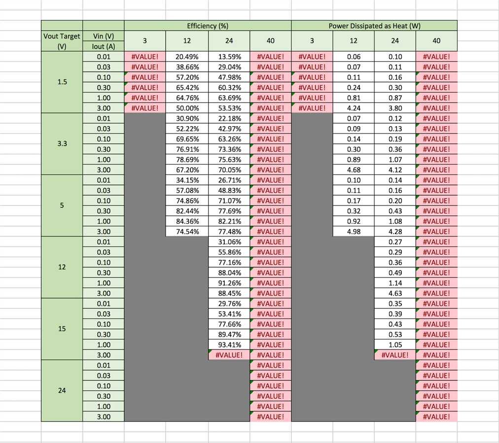

Efficiency
The following table shows the calculated efficiencies across the range of measurements taken above.
It can be seen from this that the board can have some very good performance with certain setup conditions. It peaks at 93.4% efficient at 24V input and 15V output with a load of 1A. I expect this was roughly where the initial design targeted the initial design parameters. The highest efficiency for a 5V output was again at 1A output but this time with a 12V input but it was much lower peaking at 84.4% which is still reasonable. The efficiency tails off some more at 3.3V output peaking at 78.7% at 1A load, with a 12V input.

The following table shows the regulation in terms of voltage droop in volts across the range of measurements taken above.
For the most part, just looking at the voltage measured on the output on a multimeter the droop on the output under load is very slight. The worst case is 140mV at 3A load on a 5V output. What this doesn't show is how much ripple there is on the output and this will be measured on the oscilloscope once I have switched out for a new board.
