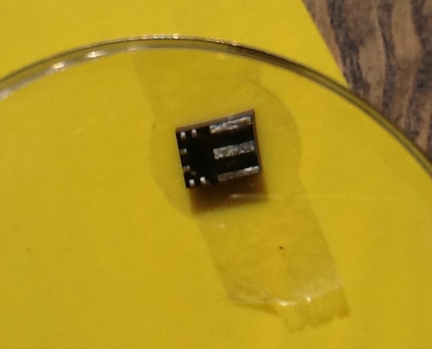

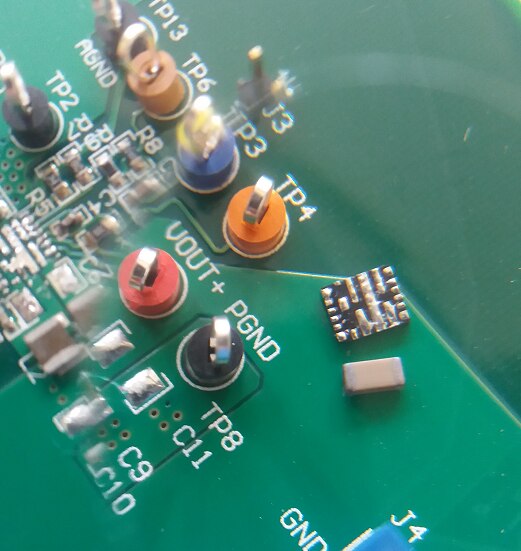

    Jan Cumps over 9 years ago +3
    You're not the only one that released the magic smoke when evaluating switchers . I've zapped two different ICs. Expensive ones

  • rachaelp
    rachaelp over 9 years ago in reply to Jan Cumps
    I'm glad they weren't expensive.... I think if I had caused the magic smoke on an expensive eval board I would have been more upset. At £1.50 it's an acceptable loss and has given me more to investigate and blog about image
