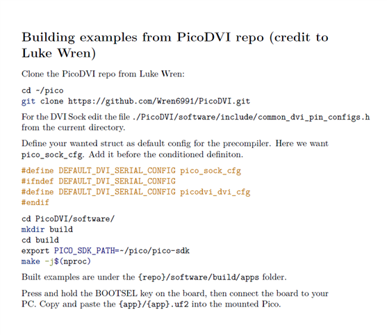

I discovered the cause of my problem - I needed to edit a configuration file.
An excerpt from the readme:
Anyway, thought I should finish trying this out.
