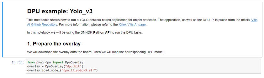

The process to upgrade PYNQv2.5 to install Vitis-AI is relatively straightforward.  If you use one of the supported boards the DPU overlay file (dpu.bit) has already been built.  For the UltraZed-EV I needed to build the overlay in Vivado - I'll decribe that when I get the UltraZed-EV working with DPU-PYNQ.
Here is the process I used for the Ultra96v2:
  1. Create new 16GB SD card using the Avnet Ultra96v2 PYNQv2.5 image http://bit.ly/2MMrXcS
  2. Boot and log into pynq web console (I use a USB3 to Ethernet dongle so I just use the URL: pynq:9090)
  3. Open a new terminal (from the web interface this will open as root)
  4. Clone the DPU-PYNQ github repo to the /home/xilinx directory:  git clone --recursive --shallow-submodules https://github.com/Xilinx/DPU-PYNQ.git
  5. Upgrade PYNQ with Vitis-AI:  cd DPU-PYNQ/upgrade; make  (this step takes about an hour to complete)
  6. Install pynq-dpu:  pip3 install pynq-dpu
  7. Copy the pynq-dpu notebooks into your home folder:  cd $PYNQ_JUPYTER_NOTEBOOKS; pynq get-notebooks pynq-dpu -p .

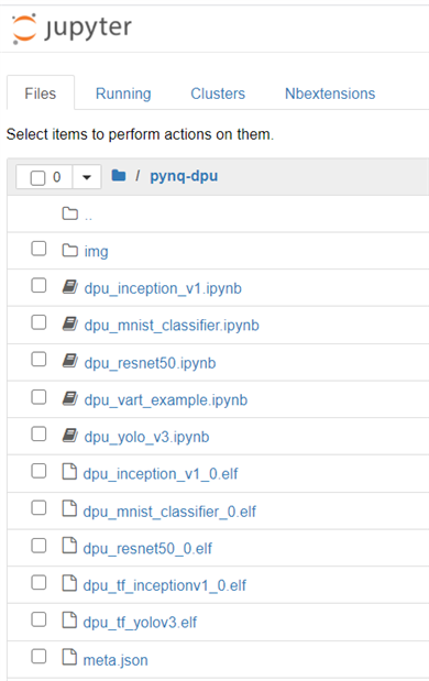

Here are the new files in the jupyter_notebooks directory:
A pynq-dpu directory for the new notebooks
There are 5 inference models included (notebooks and model files)
Inference ModelJupyter notebookModel file
Inception V1dpu_inception_v1.ipynbdpu_inception_v1_0.elf
MNIST Classifierdpu_mnist_classifier.ipynbdpu_mnist_classifier_0.elf
Resnet50dpu_resnet50.ipynbdpu_resnet50_0.elf
VART (Inception V1)dpu_vart_example.ipynbdpu_tf_inceptionv1_0.elf
YOLO V3dpu_yolo_v3.ipynbdpu_tf_yolov3.elf

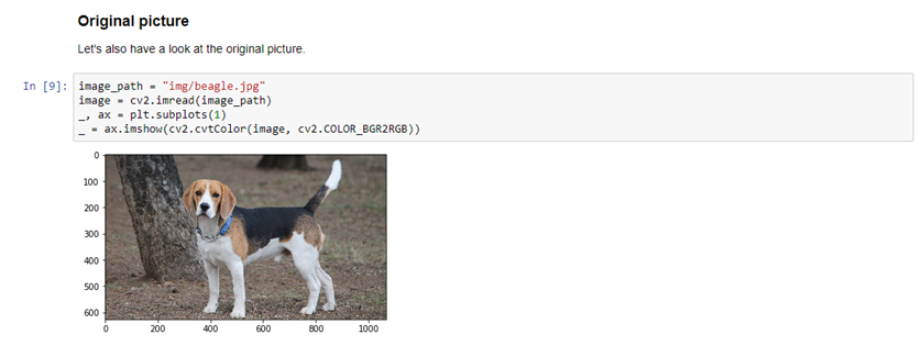

YOLO V3
I decided that I would give the YOLO V3 example a try.  Since I'm partial to Beagles I used a Beagle image as my sample picture.

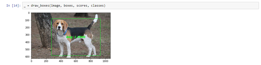

Run the application - classifies a dog with 100% confidence.

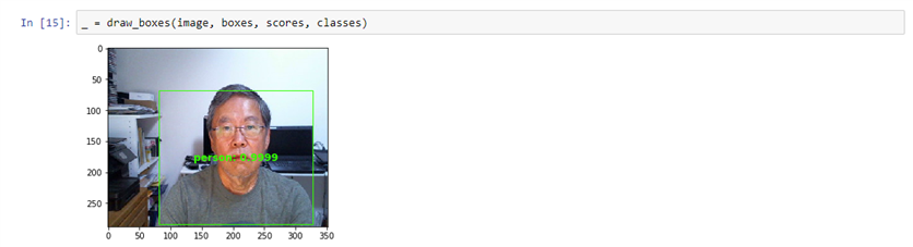

And of course this exercise wouldn't be complete without a frame capture from the webcam.
At least it knows I am a person image!
