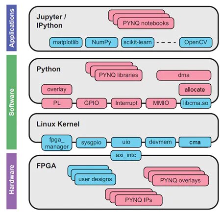

PYNQ Framework
PYNQ is useful for prototyping because you can switch out hardware designs on the fly using overlays and now with the Vitis-AI interface you can control the DPU and switch inference models quickly.  And the Jupyter notebook interface allows programming in Python or C/C++.
