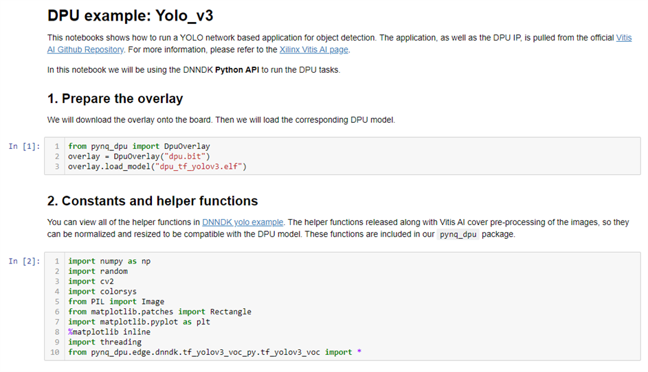

          4. Build or copy models for example notebooks.  Since the UltraZed-EV uses the same MPSoC+ device as the ZCU104, I got the sample models from here: https://github.com/Xilinx/Vitis-AI/tree/v1.1/mpsoc/vitis_ai_dnndk_samples
      • dpu_inception_v1_0.elf
      • dpu_mnist_classifier_0.elf
      • dpu_resnet50_0.elf
      • dpu_tf_inceptionv1_0.elf
      • dpu_tf_yolov3.elf
               Copy the models to the Jupyter Notebooks directory on the UltraZed-EV

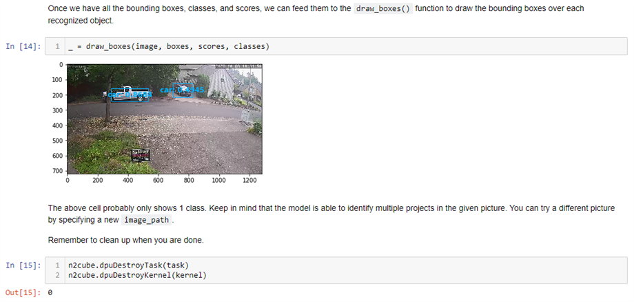

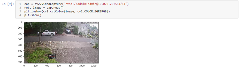

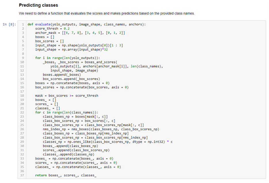

Run yolov3 example
          I modified the yolov3 example notebook to use a frame capture from the rtsp stream from my driveway IP camera.  It classifies the two vehicles in the image as cars but it is more confident with the side view than the front view.
