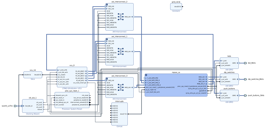

In my previous post Avnet UltraZed-EV Starter Kit Road Test - Port PYNQv2.5 , I had ported PYNQv2.5 to the UltraZed-EV using the PetaLinux BSP (uz7ev_evcc_2019_1.bsp) which is for the OOB design.  This verifies the porting process works but now I need to integrate the VCU which is not in the OOB design.
The hardware design bitfile is is loaded as an overlay in PYNQ but any drivers and software need to be installed separately.  Since PYNQ uses an Ubuntu rootfs and I am using a pre-built image, I am going to add the gstreamer packages manually in Ubuntu.  The VCU product guide PG252 includes PetaLinux recipes for configuring the hardware and installing drivers and software.  The hardware recipes are specific to the ZCU106 and ZCU104 and relate to using the PL DDR memory to achieve maximum performance.  I don't need that initially but I'll need to implement that later.   There are recipes for adding vcu driver patches and recipes for gstreamer packages that aren't needed.  So how to install the VCU driver?  It seems that if I built a BSP from the VCU TRD HDF that would associate the VCU driver.
Process to port PYNQ to VCU TRD
  • Verify that an overlay can be generated from the Vivado design (completed)
    • Upgrade the 2018.3 VCU TRD design to 2019.1 (since this is a small design there aren't many components so upgrading was not a problem)

    • Build design and export with bitstream
    • image
    • Generate overlay with .hwh and .bit files
    • Verify that PYNQ can load and operate GPIO (the VCU TRD uses the same LED, push button and dip switches as the OOB design)
