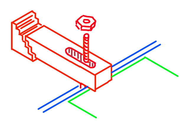

I've had great success with my inexpensive AnyCubic 3D printer that I got on Amazon Prime day, so I finally decided to get myself a low cost (under $200) CNC mill. I wanted to get something that would allow me to drill holes with reasonable accuracy and also mill PCBs.   I settled on the SainSmart Genmitsu CNC 3018-PRO.  It has an XYZ working area of 300x180x45mm which is sufficient for most things that I do.  It uses GRBL rather than Mach3 control firmware but I think that should be sufficient for a beginner like me.  One reason for the low cost is this is an assemble it yourself kit.  Good news is that even with 3 trays of parts the assembly only takes about an hour or so.

Two things that I wish that they had provided with this kit - a decent set of clamps and some sample end mills.  I couldn't figure out how to use the "clamps" that they provided and the only routing bits they provided were "V" cutters that are suited for engraving in wood.  I couldn't figure out what type of clamp to use with the small PCB, so I 3D printed a fixture to hold it and to provide the "waste board" structure under it.  Luckily I had also salvaged some short 0.8mm end mills from somewhere in my past life.

    Incidentally, if you're looking for a way to clamp a board, this is a common way of doing it with CNC/milling machines (at least for general material, I don't know about PCB), that might be possible to make with a 3D printer, if they are not already available in some size to suit your machine/bed:
    Basically, there are two separate blocks (shown in red), that have a staircase pattern on one end. That allows you to lift up the long red block, to match the height of the object (it doesn't need to precisely match, it can be slightly higher). The PCB is green. The long red block has a long oval hole at the far end, and a T-nut goes into the groove (shown in blue) on the bed, with a thread poking out (a piece of threaded rod, it isn't a bolt). The nut is fastened so that the lip of the long red block is just protruding over the PCB.
    A couple of these are normally used, one on each side. The PCB should have some scrap material under it too (as you've got).

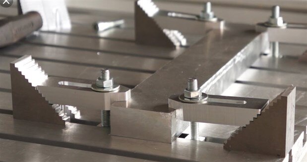

    EDIT: a photo from google images. They can be used in several ways, and these ones seem to be a variation with a notch at the clamping end, but that's not essential. Also 4 would be overkill I think, 2 could work..

    ralphjy over 7 years ago in reply to shabaz
    Hi Shabaz,
    Thanks for the pictures.  This type of clamp is more like I was expecting to get.  Should be easy to print and customize.  The ones I got are like the ones in Gene's picture.
