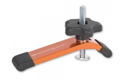

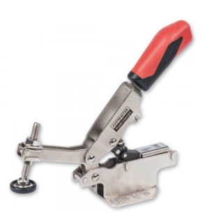

  • three-phase
    three-phase over 7 years ago
    This is a nice little machine, I look forward to seeing how you get on with it.
    There are also toggle clamps available in a variety of formats that can be useful and quite speedy.
    There are also simpler hold down clamps with a T-bolt and hand screw.
    I find these a bit more user friendly than the traditional step-block clamps, but do not give as much clamping force.
    Kind regards.
