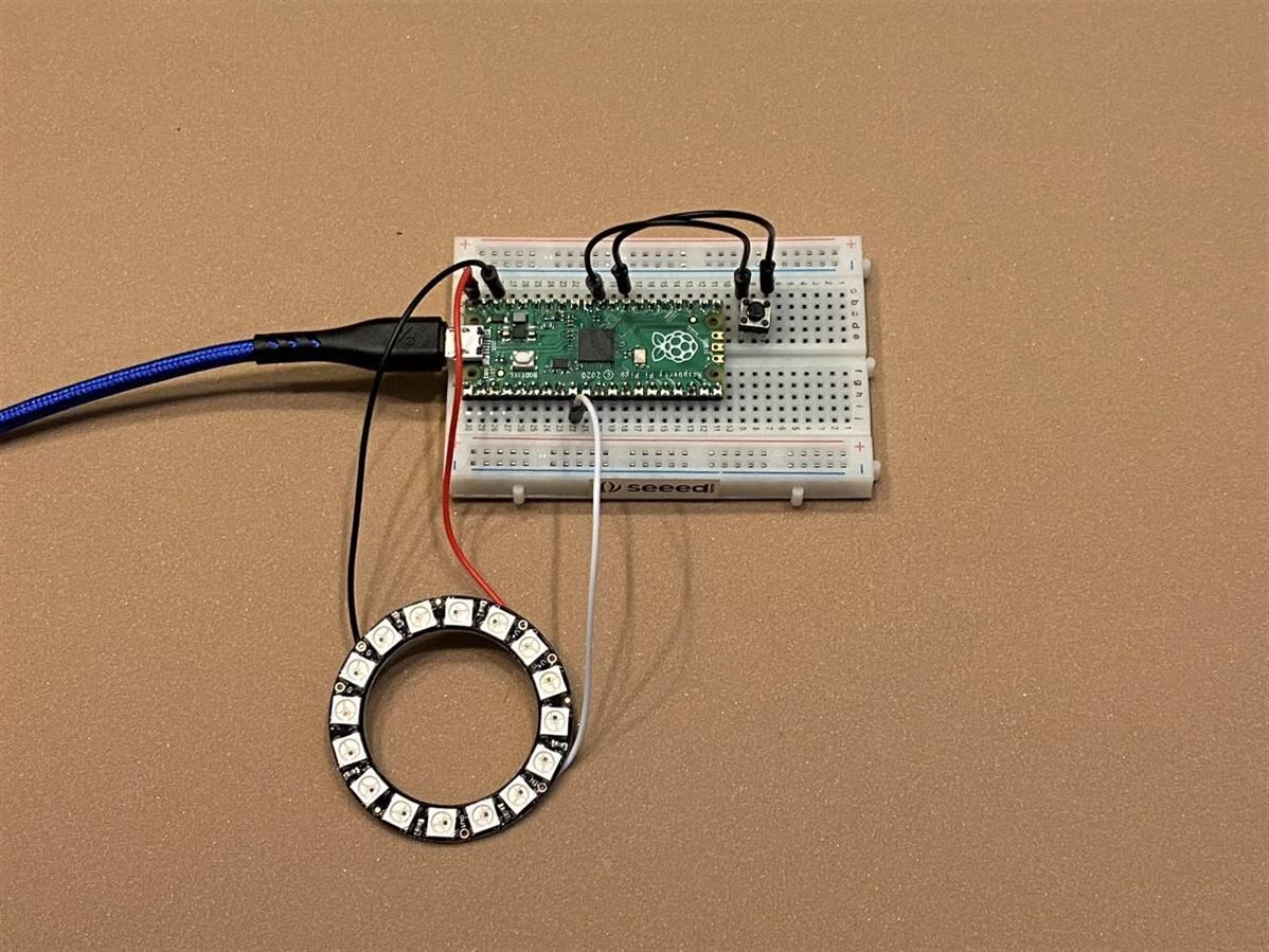

Loading MicroPython was easy since there is a UF2 file provided (https://www.raspberrypi.org/documentation/rp2040/getting-started/static/f70cc2e37832cde5a107f6f2af06b4bc/rp2-pico-202102… ) and I've added a Reset button to my breadboard so I don't have to mess with unplugging and re-plugging the USB cable to get the Pico in mass storage mode.

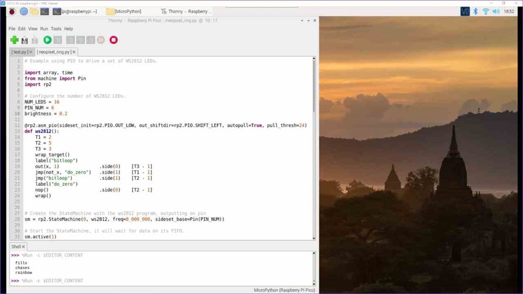

The Thonny IDE is already included in the RPi400 OS image, so I just needed to pick up some example files.  I thought it would be fun to try out the NeoPixel ring since I had one handy.  There is code available on the github repo pico-micropython-examples https://github.com/raspberrypi/pico-micropython-examples/blob/master/pio/neopixel_ring/neopixel_ring.py#L1-L104 .
Here's the basic hookup - just +5V, Gnd, and GPIO 6 for the NeoPixel ring.  You can also see the Reset button that I have wired between the Run pin and Gnd.
Here is the program loaded in Thonny (I'm using VNC to operate the RPi400 remotely).
