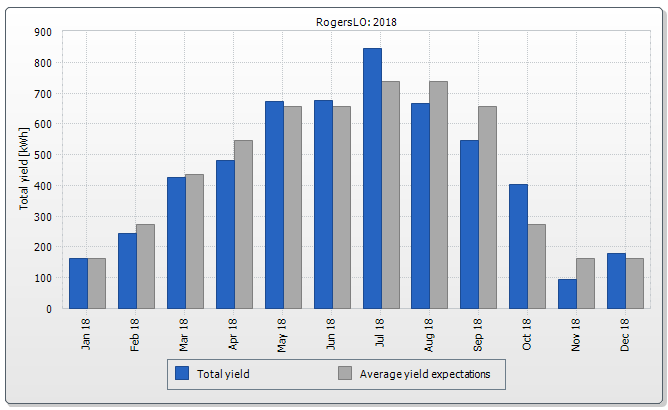

Here is a graph of my yearly production that I got from the SMA website.  The yield expectation was my best guess at how the estimated power would be distributed.
The total power generated was 5.38 MWhrs.  My total power consumption was 5.20 MWhrs.  So, I ended the year with a surplus of 180 kWhrs.  It's too bad the power company doesn't pay you for that excess energy that gets put back on the grid.  It turns out that I should have gotten another 100-150 kWhrs of power but the inverter shutdown in November due to an "electric arc fault".  And, of course, Murphy's Law says that would happen while I was on vacation in New Zealand so the system was down for 11 days.  Have not determined what caused that fault; the system restarted cleanly.
The shadowing was a lot larger effect than I expected.  I could have requested a more extensive simulation to model that effect but it didn't seem to be worth the time and effort.  Since I have a south facing system the effect only occurs from October through April when the sun's inclination is much lower.  The other five months the sun's path is high enough that I don't get any shadowing.  Since I am currently exceeding my power consumption, it probably would not have been worth the extra cost of using micro-inverters rather than the string inverter to provide additional margin.

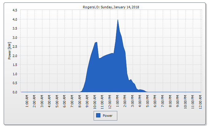

Yield on January 14 was 13.38 kWhrs.  The steep slope at 9am and 2pm are due to the trees and the notch is due to the chimney.  The sun angle is so low that I only get a brief period at 1pm when I get full sun on all the panels.

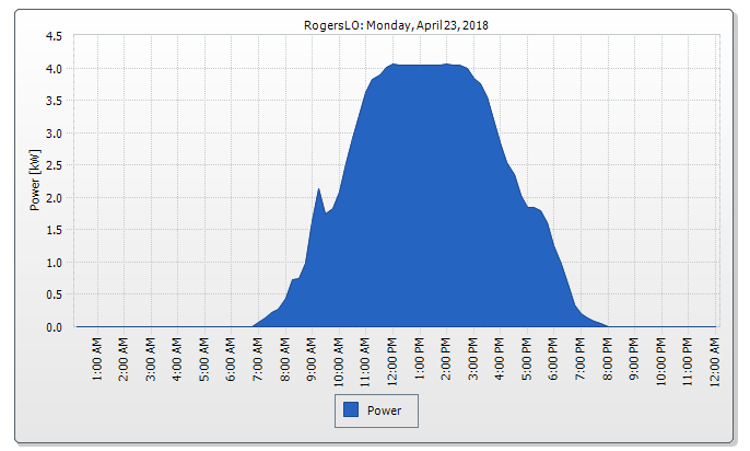

Yield on April 23 was 30.11 kWhrs.  The shadowing from the trees is reduced and there is no shadowing from the chimney.  You can see that the inverter is clipping as the panels are operating close to maximum efficiency.  The ambient temperature was about 20C.

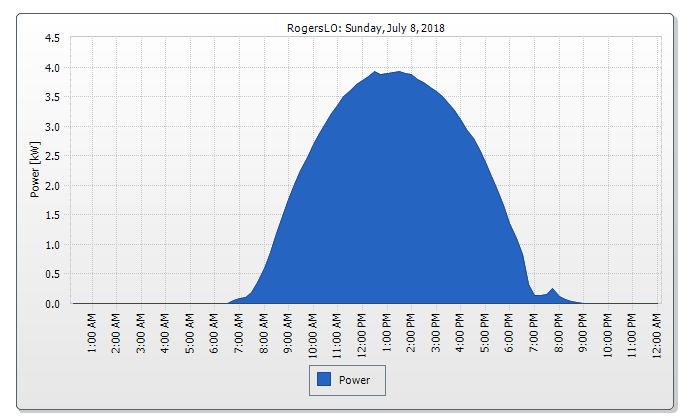

Yield on July 8 was 30.83 kWhrs.  There is no shadowing during the summer due to the high sun angle.  One thing that I did not anticipate was the reduction in panel efficiency due to heat.  You'll notice compared to April's graph that the inverter is not clipping because the panels are producing less than optimal power.  The ambient temperature was about 35C and I'm sure it was much hotter on the roof.  So, it turns out that a good day in the summer is not much better than a good day in the spring (although there are many more good days in the summer).

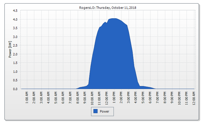

Yield on October 11 was 21.52 kWhrs.  You can see the shadowing from the trees is back and the shadow from the chimney is just starting to fall on the lower string.
