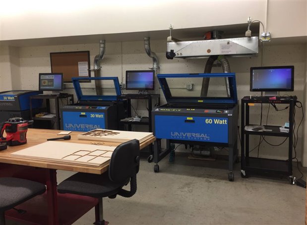

I've wanted to try using a laser cutter but haven't had the opportunity until today.  There is a campus of Portland Community College (PCC) just up the hill from me.  Spring term was the first time that they've offered Maker community education courses (3D printing and laser cutting).  I was fortunate to get into the first laser cutting class.  They have 3 laser cutters from Universal Laser Systems in their MakerLab.   They have a 60 Watt model with a work area of 32"x18"x9", a 30 Watt model with a work area of 24"x12"x9" and a 30 Watt model with a work area of 16"x12"x4".  They mainly work with wood and plastics and active ventilation is required to remove the smoke that is generated.  They don't have the capability to process metal.  The class that I took was a single 3 hour introduction to laser cutting but even with the queuing time we were each able to make a pre-designed LED "lantern" box and also a project that we designed ourselves.  The software that they use to design the projects is Adobe Illustrator.
Laser cutters

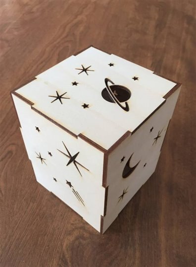

LED lantern box
You can see the good detail in the cutouts.  I was impressed by the ring around the planet.

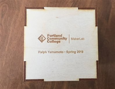

Here is the bottom with the MakerLab logo engraved into the wood.  Engraving is done at a lower power level and it takes longer than cutting does.

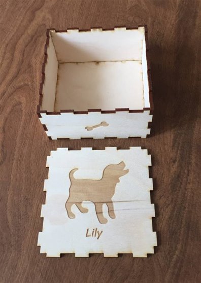

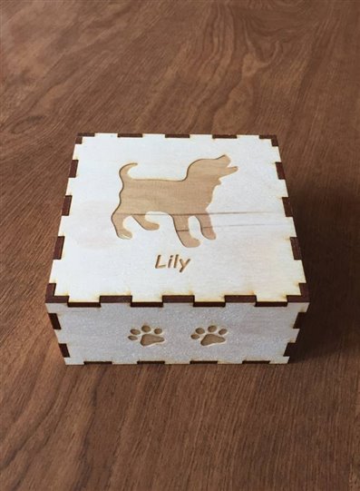

For my individual project I designed a "treat" box for my granddog.

    The focal length of the lens is 2", so it is a fair distance from the material being cut.  The cutting does generate a quite a bit of smoke (at least with wood).  I should have tried to get a video with my phone.  The instructor said that they have to clean the smoke residue off the lens assembly at least daily because the laser can heat the deposited residue and damage the lens.  Seems like they would have made this process easier but at least it's only a few non-captive screws (they do it over a sheet of paper so dropped screws don't get lost).

    The laser has settings for pulse frequency (pulses per inch, PPI) and power (percentage).  The drawing program assigns settings by color so in this instance black was set to cut through and red to do the engraving.  Reasonably intuitive to set up but as with a 3D printer you can do a lot of tweaking.  If you get the settings wrong there's a lot of smoke and sometimes fire.  I think that's why they restrict materials that are used until they can thoroughly vet them.  With these cutters the height calibration was mechanical (against a standard "post") not optical.
