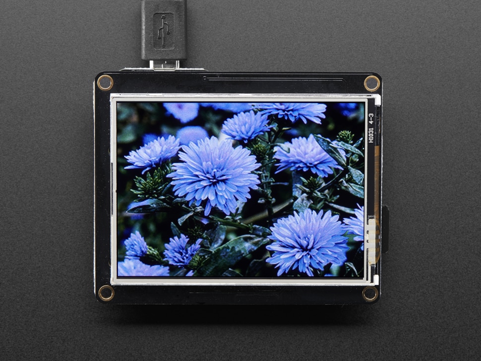

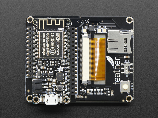

The nice thing about using a Feather compatible footprint is that all of the FeatherWing accessories are available for use.  It would be great to integrate a small display with the MAX78000FTHR to create a portable smart camera.  A stacking display can't be used because it would block the camera and stacking displays don't have very high resolution or appropriate aspect ratio.
Adafruit makes a couple of nice TFT FeatherWings that would mount the MAX78000FTHR on the back which is the perfect setup.  There is a 2.4" 320x240 Touchscreen and a 3.5" 480x320 Touchscreen.  I opted to get the smaller one https://www.adafruit.com/product/3315 .
Here's a couple of pictures from the Adafruit product page that shows the display with an ESP8266 Feather mounted on the back.

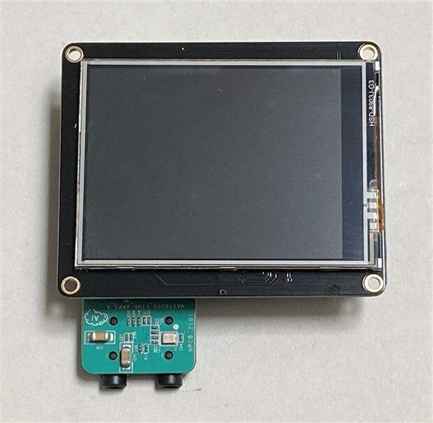

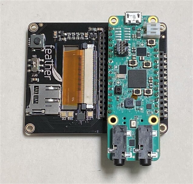

And here's my setup.  The MAX78000FTHR board is longer than a standard Feather in order to accommodate the stereo audio in/out jacks.
I printed a cover to facilitate using this setup as a portable smart camera.  For this purpose, the audio jacks just get in the way.  It would have been nice to have a version of this board in the shorter Feather form factor.
I was surprised at how tiny the VGA (640x480) camera is. It's about 3x3mm - you can see it at the left center of the board.  Here's a link to the sensor https://www.ovt.com/download/sensorpdf/46/OmniVision_OVM7692.pdf .

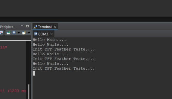

    Hi All;
    im working with MAX78000FTHER with an Adafruit featerwing V2, with eclipse on windows, my code is compiling without any error , i just want do an tft_Demo application but its not work, plase check my code below and sent me some feedback.
    i put some printf and im using the eclipse terminal output to check if the code is working and receive this output, but the display remains blank
