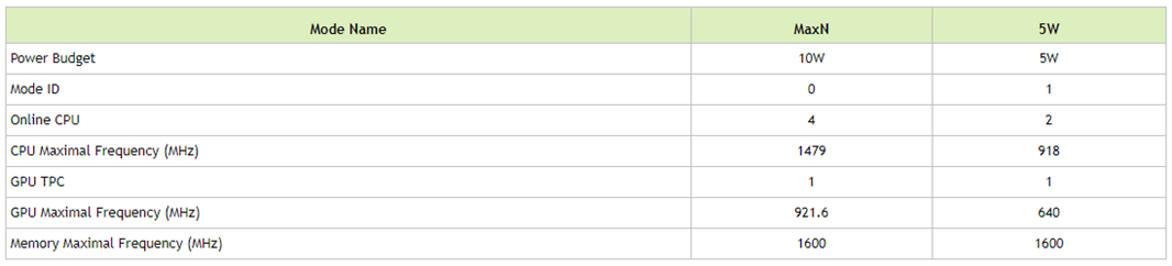

I noticed in YouTube videos that everyone uses the 4A power supply with the barrel jack.  I guess I should have checked earlier.  The default standard power mode is 10W.   It is supposed to be marginal with the 2A micro USB jack. There is a 5W power mode that you can select that reduces the CPU and GPU performance.

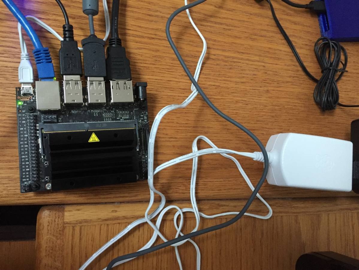

I just ordered the Adafruit power supply model that is recommended but they are out of stock at Adafruit and Newegg.  I guess the Jetson Nano must be popular.  I won't get the power supply for another week.  In the meantime I'll just try out the micro USB input using my Raspberry Pi 2.5A supply.  Here's my setup:
It took me a while to get running.  The SD card image is over 12GB!
So far everything seems to be running okay in the default 10W mode.  I've had some minor issues with Ubuntu 18.04.  I guess they've locked down some security holes and I can't figure out how to get access to the primary display (:0) over VNC.
It took me a while to figure out how to find and compile the JetPack sample programs but I'm starting to find my way around.
