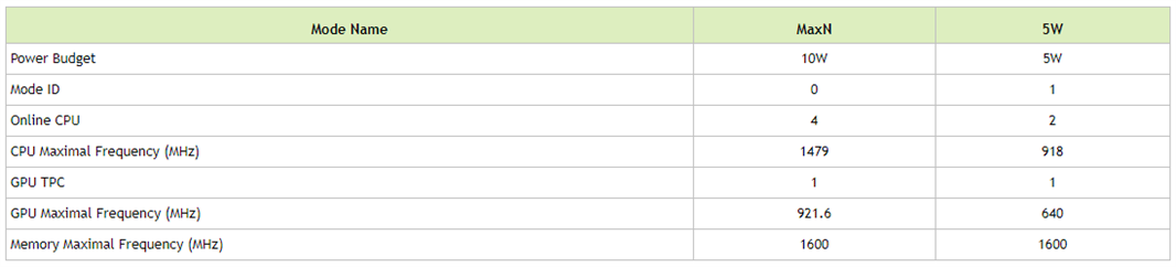

I noticed in YouTube videos that everyone uses the 4A power supply with the barrel jack.  I guess I should have checked earlier.  The default standard power mode is 10W.   It is supposed to be marginal with the 2A micro USB jack. There is a 5W power mode that you can select that reduces the CPU and GPU performance.
