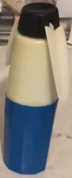

    About 20 years prior, if you wanted to maintain your street cred, you had to make do with one of these things:
  • stanto
    stanto 1 month ago in reply to beacon_dave
    My fingers hurt looking at this nostalgia, it was lethal with a fully charged battery.
  • stanto
  • beacon_dave
    beacon_dave 1 month ago in reply to stanto
    I recall the position of the switch not being the best - the knuckle of the thumb could get hit by the blade tip spinning up.
