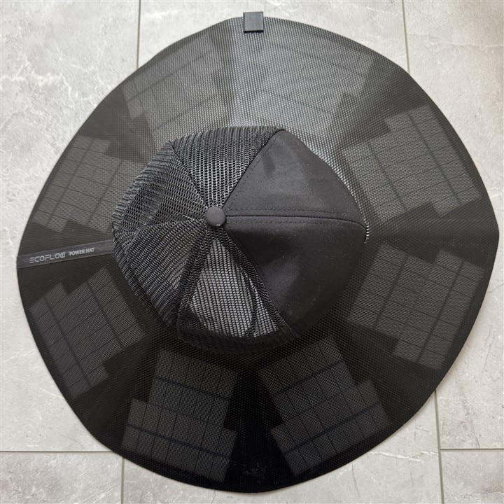

This weekend I thought I would combine a couple of unused items into something useful for summer dog walks.

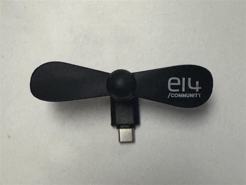

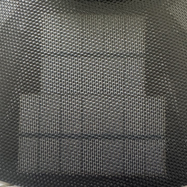

I received an EcoFlow Power Hat this past Christmas, but haven't come up with a use for it until now.  The hat has eight Perc Monocrystalline Silicon solar panels mounted in a wide brim.  It has a voltage regulator and USB-A/USB-C ports that have a max output of 5V @ 2.4A.  It's advertised for charging cellphones and battery banks when you are off-grid.  I also have a bit of E14 swag - a USB-C fan that I thought I would attach to the hat to provide some cooling when I'm out with the dogs.  The fan draws about 350mA, so it shouldn't be a problem even with a partly cloudy day.

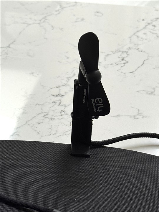

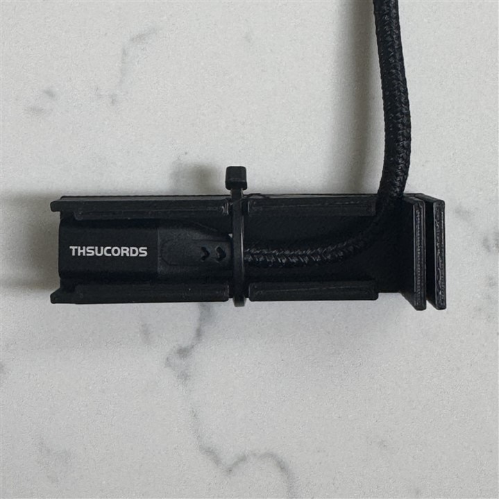

I bought a short USB-C extender cable from Amazon and printed a brim mounted bracket for the fan.
Bracket with USB-C socket
Fan mounted to the brim

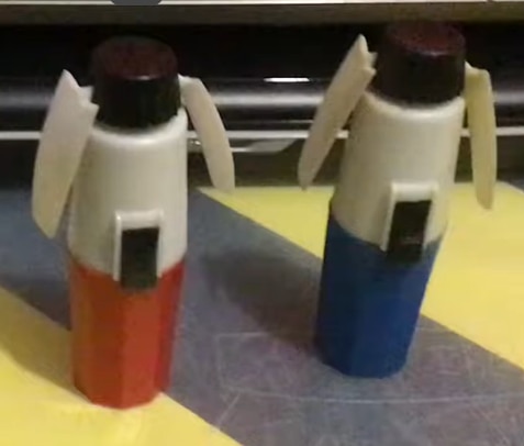

  • beacon_dave
    beacon_dave 3 months ago in reply to shabaz

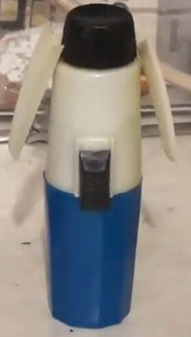

    Looks like there was a red/white version
    shabaz 3 months ago in reply to beacon_dave
    Wow, recall seeing that in school days! I don't know if it came in any other colour scheme, it was just Blue/White from memory.
  • Gough Lui
    Gough Lui 3 months ago in reply to beacon_dave
    I certainly had one of these. They actually made batteries run quite hot - especially for the ones where the motor was directly connected to the battery as likely the commutator shorts for a brief period every half-turn on bad quality DC motors. I think some of them had some suppression capacitors to improve the situation.
    - Gough
  • beacon_dave
    beacon_dave 3 months ago in reply to stanto
    I recall the position of the switch not being the best - the knuckle of the thumb could get hit by the blade tip spinning up.
  • stanto
    stanto 3 months ago in reply to beacon_dave
    My fingers hurt looking at this nostalgia, it was lethal with a fully charged battery.
