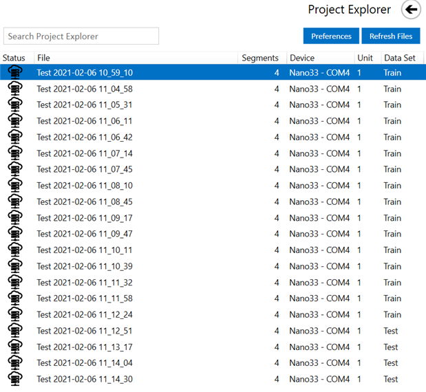

I captured 20 data sets with each of the data classes within each set and then I segmented and labeled the data.  I added an additional metadata tag "Data Set" to differentiate data used for training and data used for testing.  I tagged 4 of the 20 sets (20%) for test as shown in the Project Explorer of DCL.

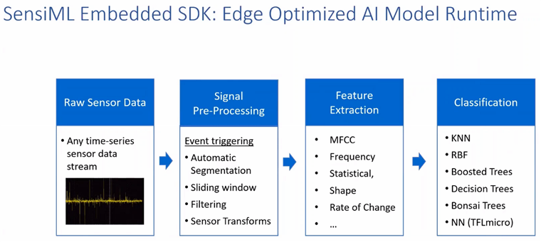

Here's a diagram of the tool flow:
And a diagram of the Analytic Studio Flow:

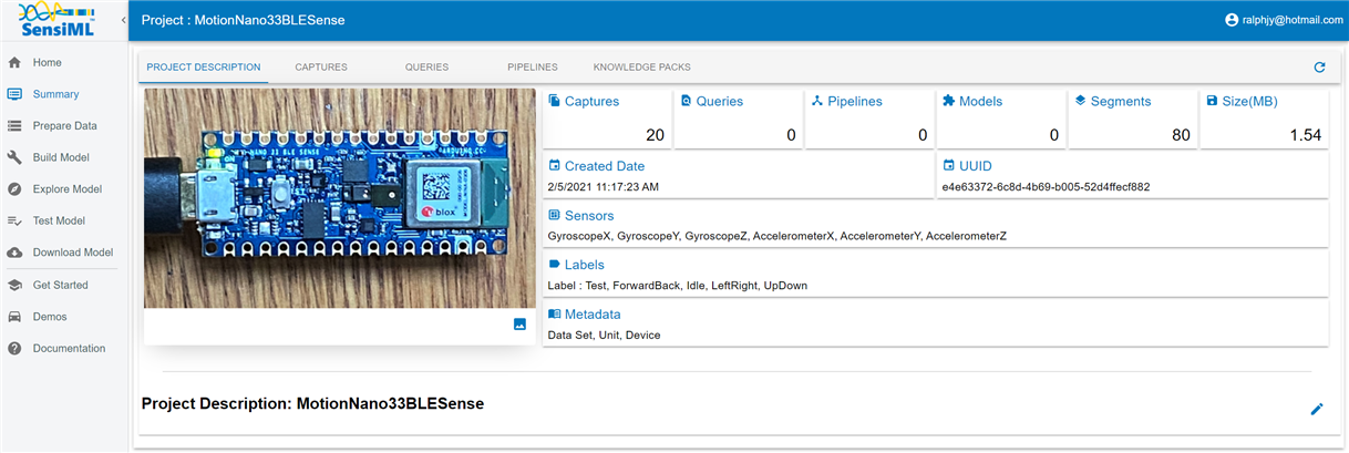

The Summary page for the project - I'm just starting so the only thing currently showing is the 20 Captured data sets plus a picture that I added:

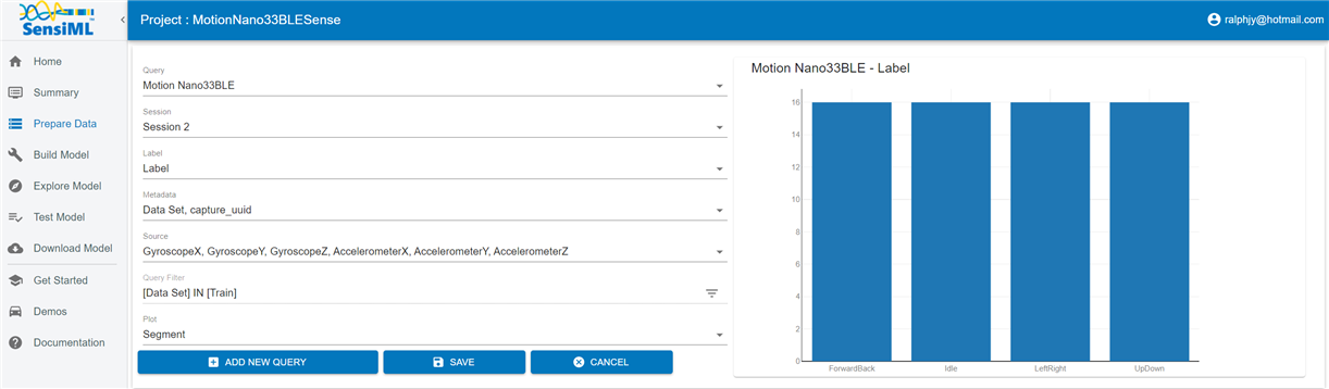

The first step to building a model is to prepare the training data set.  This is done by creating a query to extract the data from the data set.  Here is the query that I created.  You can see that 16 instances of each class was extracted from the data set.

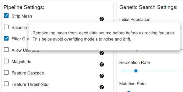

There are also some advanced settings to optimize pipeline parameters.  This is something that I'll need to learn more about:

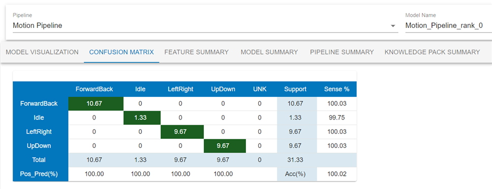

And the Confusion Matrix:
And Feature Summary:

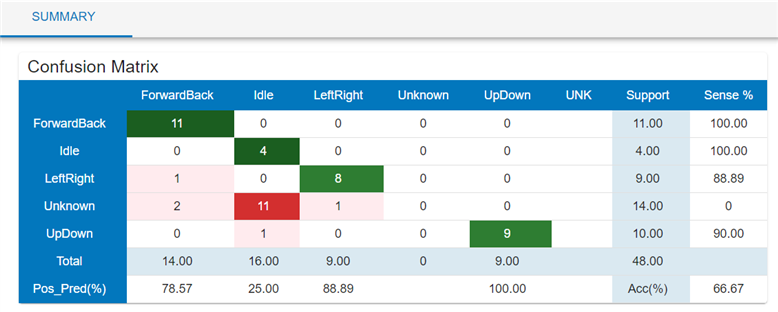

And the results are not that good.  But the reason is apparent when looking at the Confusion Matrix:
The problem is with the Idle class.  I'll need to go back and look at the training and test data and maybe try different window sizes.  I'm testing with data sets that have all 4 classes within the set and variable spacing between the classes.  I think I'll make sure there isn't any issues with simpler test data.

    ralphjy over 5 years ago in reply to DAB
    There are little "?"s next to the settings that provide basic info, e.g. this one for the Strip Mean setting.
    Here is the link to their docs for AutoML parameters https://sensiml.com/documentation/analytics-studio-notebook/sensiml-automl.html
    Doubt if you will get a lot of insight into the algorithms.
