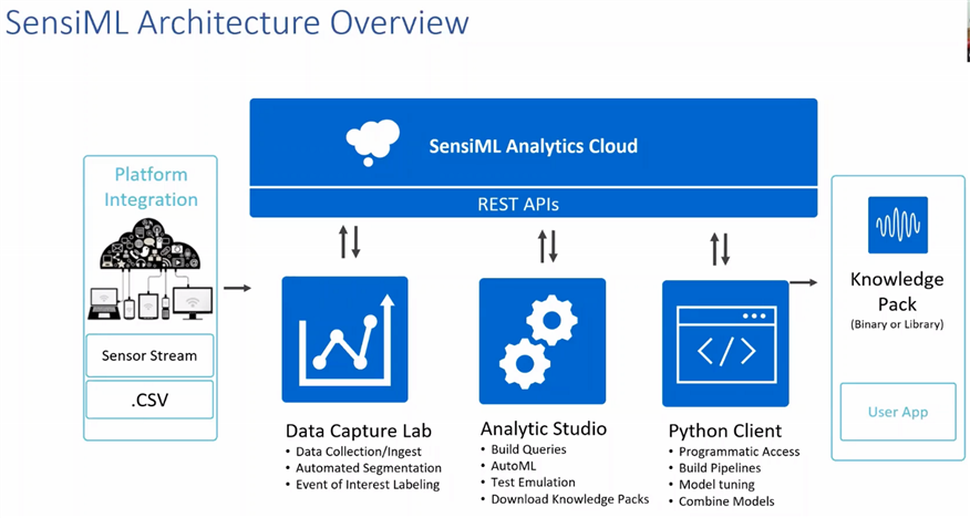

SensiML Analytics Studio
Analytics Studio is a web browser based application that you log into with your SensiML account.
Projects that you create in Data Capture Lab will show up in Studio, as will the captured data.
Here's a diagram of the tool flow:
