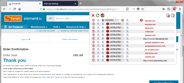

  • johnr2
    johnr2 over 7 years ago in reply to ChristyZ
    Christy, the problem here is the amount of off-site scripts that have to be enabled to make the web pages load in a reasonable time. NoScript lists the following: bing.com, demdex.net, baynote.net, hs-analytics, hs-scripts.com, omtrdc.net, criteo.net, marinism.net, google-analytics.com, googleadservices.com and facebook.net.
    None of those are appropriate for a professional electronics supplier's site IMO. I used to be able to use the site just by temporarily enabling scripts from farnell.com, but not since I updated my version of Firefox to 52 ESR (running on OpenBSD 6.2) along with the current version of NoScript around a month ago.
    To re-iterate, scripts from the company I'm doing business with are ok, but I don't want other companies involved in what should be a private transaction. Allow these scripts for those who want them by all means, but choosing not to load them should not prevent a customer from being able to submit an order. No other supplier I deal with imposes this restriction.

  • johnr2
    Christy, thanks for the reply.
    I can get the farnell.com site to work properly if I set NoScript to allow scripts globally, then restart Firefox. It continues to work if I then set all scripts individually to 'Untrusted' apart from the ones from farnell.com.  I can use this as a workaround.
    If I set NoScript to forbid all scripts globally, then temporarily allow farnell.com, I just get a blank white page that hangs indefinitely.
    I tried installing Firefox 56 (the latest version available for OpenBSD 6.2) but the behaviour remained the same.
    Interestingly, if I use the Dillo browser which doesn't support HTML5 or JavaScript, I can navigate the site quite efficiently including using the search engine (but the shopping basket doesn't work, presumably because it needs JavaScript).
    I'll stick with the aforementioned workaround for now. Thanks for looking into this.
  • johnr2
    johnr2 over 7 years ago in reply to johnr2
    Further info: whitelisting farnell.com in NoScript settings also works properly (without enabling scripts globally).
    Whitelisting obviously does something different from temporarily allowing sites, which surprised me.
