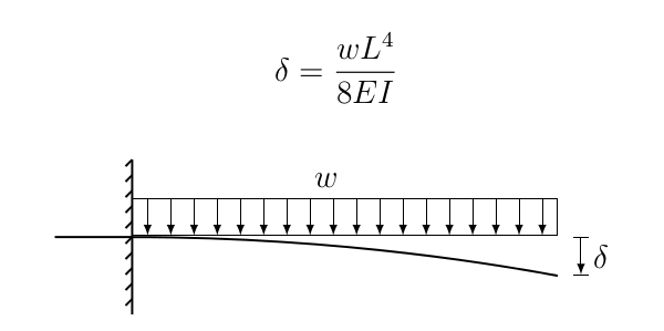

Uniformly Loaded Cantilever
Here is one standard solution of the differential equations, the uniformly loaded cantilever. A cantilever is an idealised beam which is fixed at one end (that end can neither move nor rotate) and otherwise totally free, a good description of a pole embedded in the ground at one end. The uniform loading is a force spread out evenly over the whole length of the beam, which can be used to approximate wind loading. Here's a diagram, and how much the beam deflects under uniform loading:

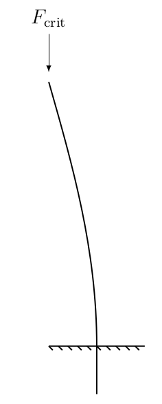

Euler Buckling
An important test of our structural design is whether the poles will stand up under their own weight! A slender (significantly longer than it is wide) beam, when subjected to compressive forces along its axis, will tend to fail by buckling. Euler buckling theory notes that buckled structures take on a sinusoidal shape. We can work out how much energy is needed to bend a beam into a particular sinusoidal deformation and, using conservation of energy, equate this with the energy expended by the force causing our beam to buckle! This trick lets us estimate the buckling force of a beam which is free to rotate at each end:
Our poles are, however, not free to rotate at each end – the end embedded into the ground will always remain straight. A handy observation is that the centre of the beam above always remains horizontal regardless of how much the beam buckles. Therefore, the buckling of a beam fixed at one end is identical to one half of a freely-mounted beam buckling. Equivalently, to find the buckling force of a fixed beam with an axial compressive force applied at one end, we just use the formula above but double the length of our pole!

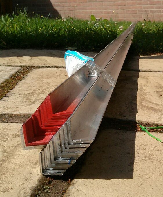

Having settled on aluminium poles and determined the stiffness we require, we needed to decide between the vast array of specifications on offer. Engineering and construction metals come in a dizzying variety of cross sections, each intended for different uses and with different strengths and weaknesses. The optimum cross section for our use (maximum stiffness in all directions with minimum material) would be a thin-walled tube, however due to the relative complexity of manufacturing tubes this is one of the more expensive options. Equal angle section (two flat pieces of equal width and thickness in a right-angle) was considerably cheaper due to its ease of manufacture and regularity of use and would work nicely for our purpose.
Our final design was poles constructed from 3m lengths of aluminium equal-angle section, each side being 3/4” wide and 1/16” thick. These poles can easily support their own weight (and the weight of LED strip!) when vertical, and give little deflection under wind loading up to severe gales. After an order with a metal stockist and a few days of waiting, we had our metal:
