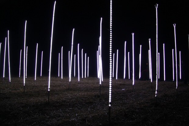

The idea was settled – we would create a 7-by-7 grid of poles, each standing 2.5m tall.  Each would be illuminated by bright white LEDs which make a noticeable click when switched on and off.  They would display a number of pre-programmed patterns in addition to interactive modes which depend on the movement of people inside The Grid. All that was left was to work out how to make the poles strong enough, what materials to choose, creating the control electronics, calculate voltage drops over the long wire runs, write a whole bunch of software, and install the whole thing into a field...
