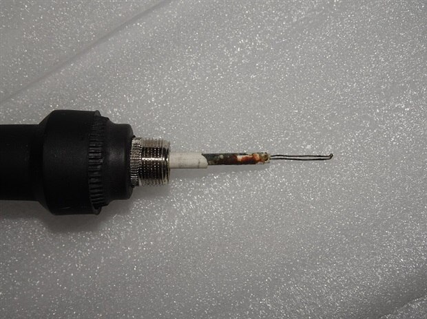

    My recent worst experience is soldering of XT-60 connector with li-po battery. My usual soldering iron suddenly stopped working (heating element issue and waiting for replacement) so as a quick replacement I bought this low cost Chinese XXXX soldering station iron from local market and when I tried to solder the connector its heat was not enough to melt the solder. After spending lots of time on single connector I disassemble the soldering iron to check why its not providing enough heat and found out that heating element is cheap Nichrome one so I decided to break the the outer shell and then decided to directly use the coil as heating source for the soldering of that connector.
    Cheap Chinese soldering station iron's Nichrome heating element with K-type thermo-couple (with broken ceramic outer-shell).

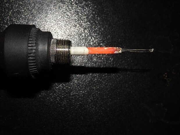

    Turned on soldering iron

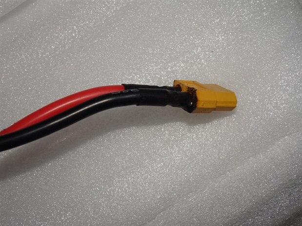

    After lots of trouble, I was finally able to solder the XT60 connector with li-po battery but it was looking horrible. But for the time being I was happy that it was soldered with battery and I can test the rest of the hardware.
    My worst soldering experience ever.

    The XT60 lipo battery connectors are a real pain to solder. The large gold-plated terminals and copper wire can act as heatsinks, making it difficult to melt the solder. The plastic connector prefers to melt before the gold-plated terminals and wire are at temp for the solder to melt. Your results look much better than my previous attempts.

    Yes it is difficult to solder but with right soldering iron (higher power) and right tip it is not a very difficult thing to do.
    All this happen because I mysteriously lost heating element of both of my soldering iron in that week so this was my quick alternate solution.
    At the end I was able to solder it but it took too much time and looks horrible.

    I agree with you. It requires a higher temp of the soldering tip. I have had recent success with a Hakko soldering iron and Hakko hoof-type (bias cut) soldering tip. It provides enough surface area to heat the large gauge wire and lipo battery connectors. As you have experienced, my work is not beautiful to the eye but the solder joint has good contact and mechanically sound. Heat-shrink wrap does well in masking these blemishes. This type of large gauge wire requires a bit of finesse to solder. The lipo battery that I had purchased did not have the correct XT60 connection that my application required. In the future I will search for a battery with the appropriate connection.
