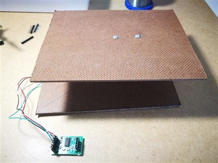

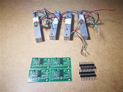

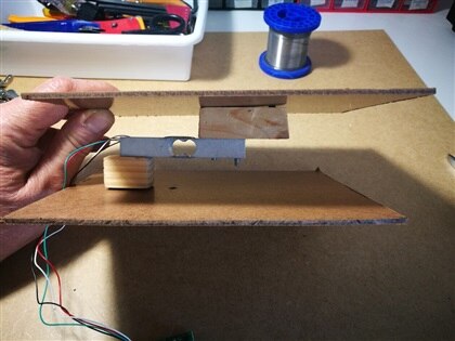

The first step was to find the right weight sensor and test its sensitivity. I should thank to michaelkellett that addressed me in the right direction; I bought a first series of four scale sensors in the weight range of 0-5 Kg and about half gram sensitivity for 3$/piece including the HX711 based amplifier circuit (the IC datasheet is in attach to the bottom of this post)
Using a 3 mm MDF sheet I have created a simple test sample to see the kind of data I should expect; after writing a few lines of code to show the readings on the serial terminal from an Arduino UNO I got a satisfying result and I definitely adopted this hardware solution.

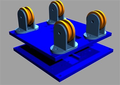

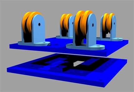

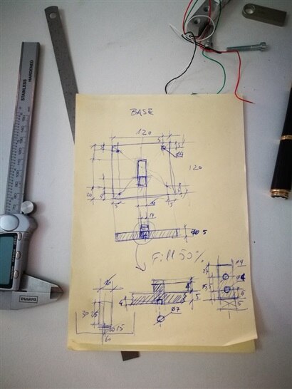

The filament roll scale design

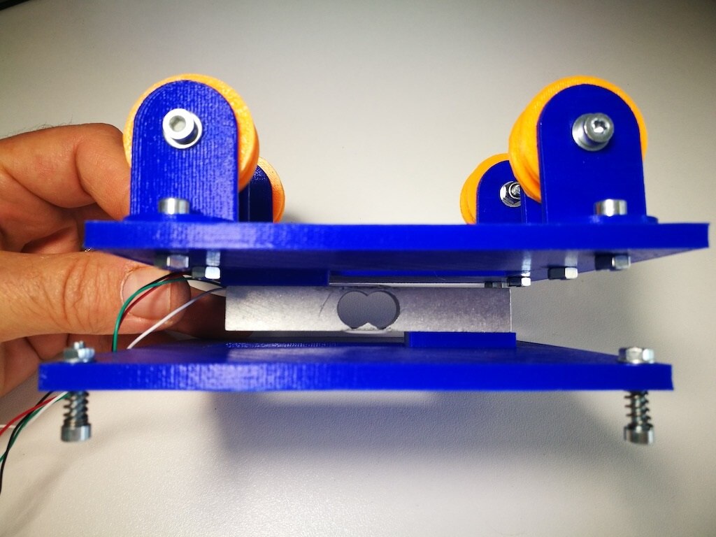

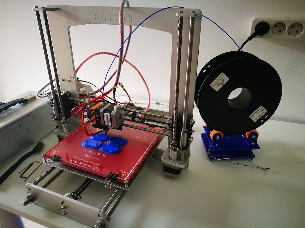

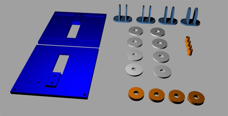

Recycling the idea of my 3D printer filament spool holder design I have made the design of a compact scale supporting a rotating filament roll as shown in the images below. As shown in the 3D representation the filament roll lies on the four wheels that rotates free and the support is connected to the base through the scale sensor.
One support can be entirely built 3D printing 22 pieces with some M3 and M4 Allen screws and nuts at a very low price

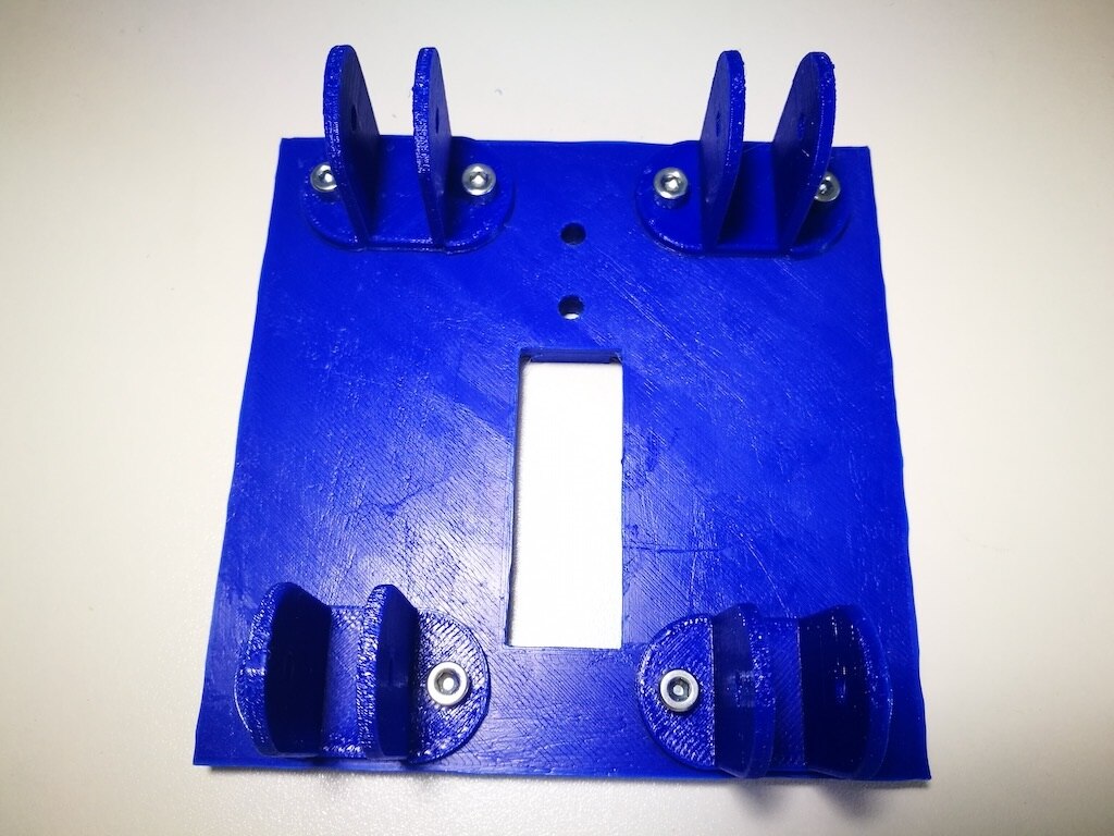

Assembling the parts

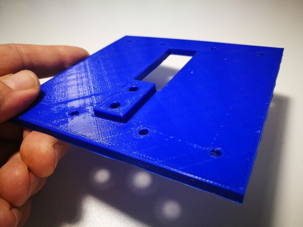

After all the 22 pieces has been printed can be easily assembled together. The top and bottom surfaces will be the filament spool support and the weight material scale at the same time. The filament is tensioned by the extruder so the roll should be free to rotate lying on the four free wheels (the orange ones). As shown in the assembly steps in the image gallery below top and bottom sides of the support are joined through the load sensor. It should be in the range 5-10 Kg max to support the filament roll that weight between 1,5 Kg and 2,5Kg (2Kg plastic rolls).

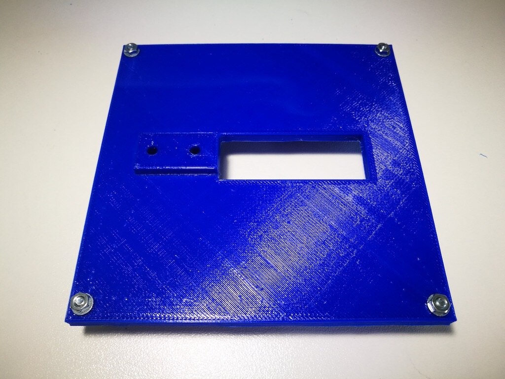

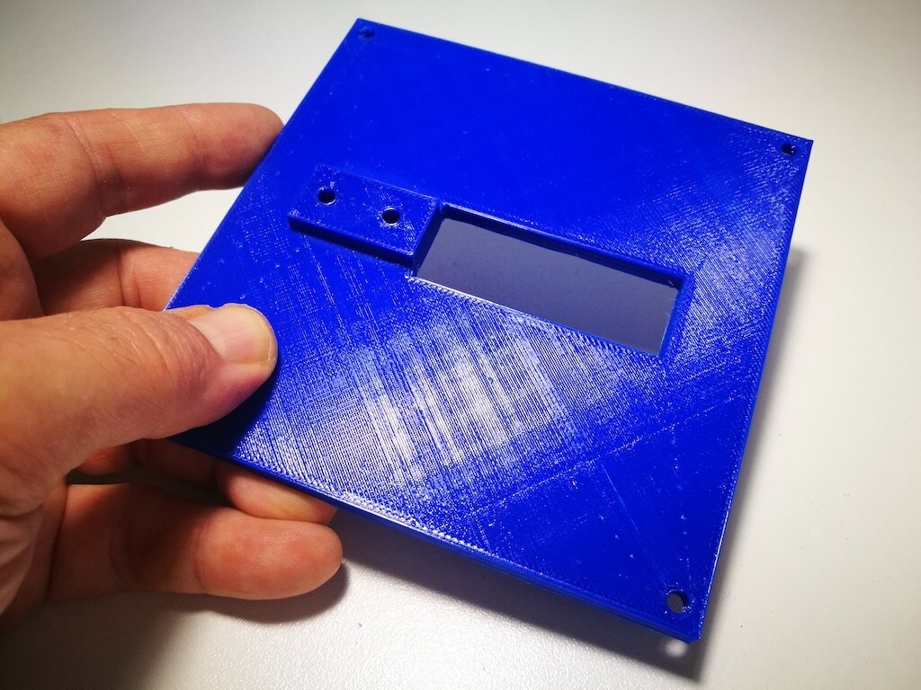

3D printed base
3D printed top

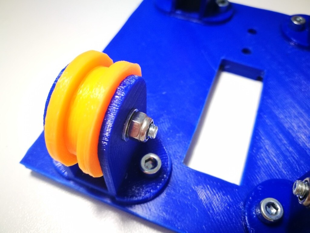

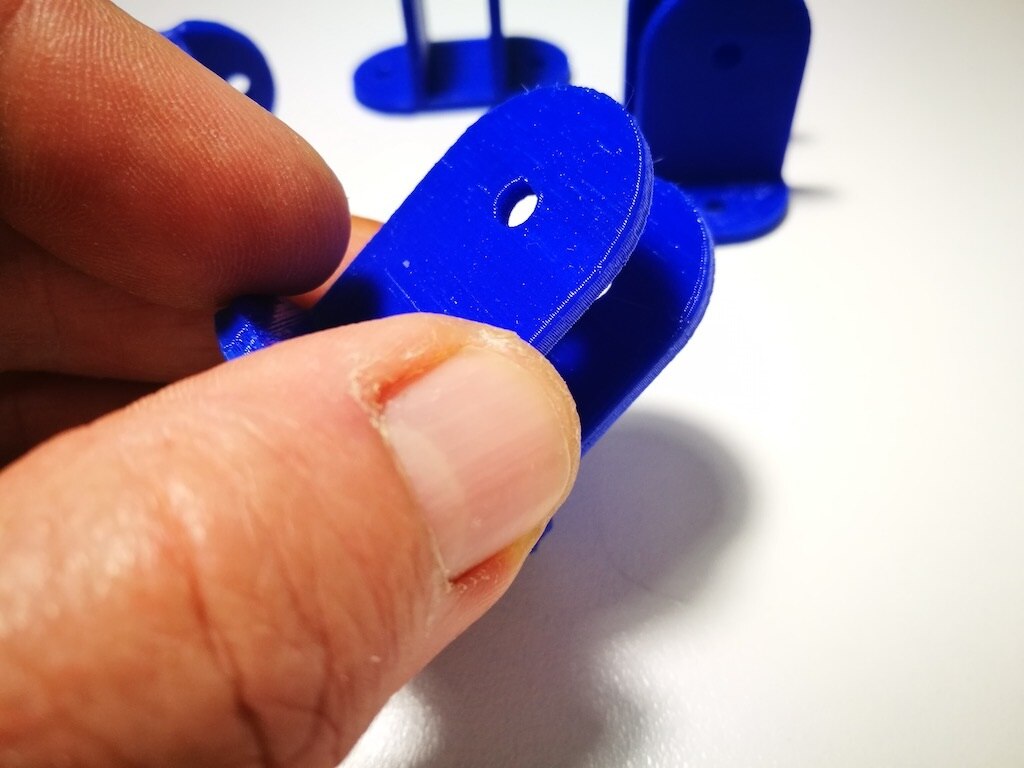

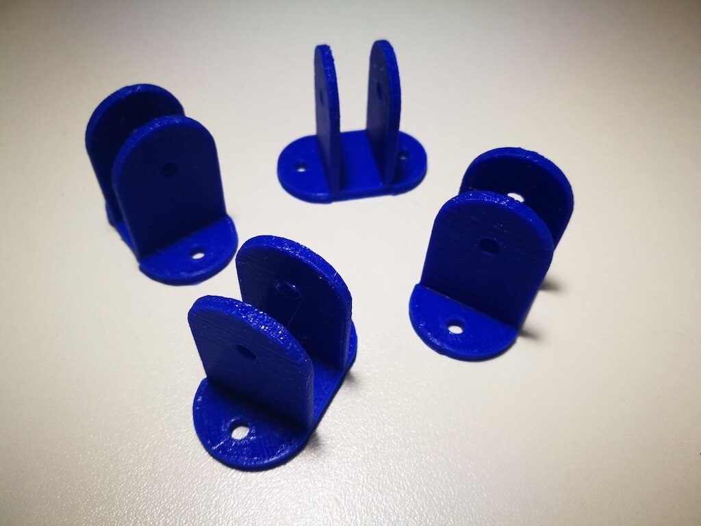

The free wheels supports
The free wheel supports

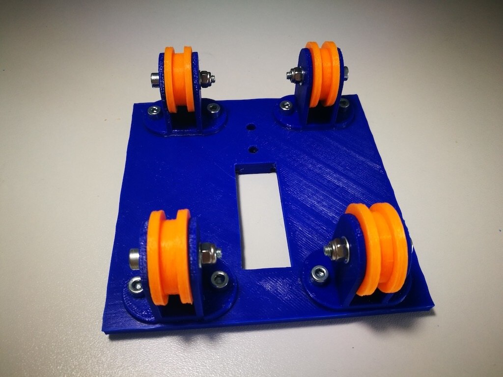

The free wheel supports mounted on the top part
The top part with the free wheels assembled
Free wheel detail (top support)

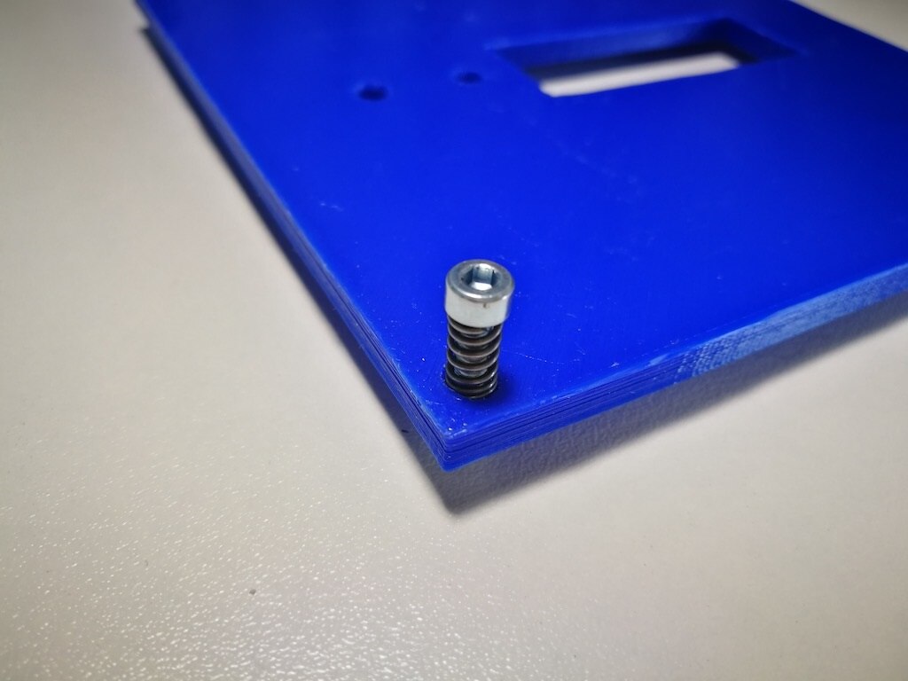

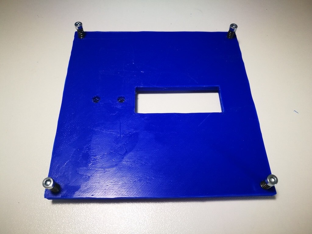

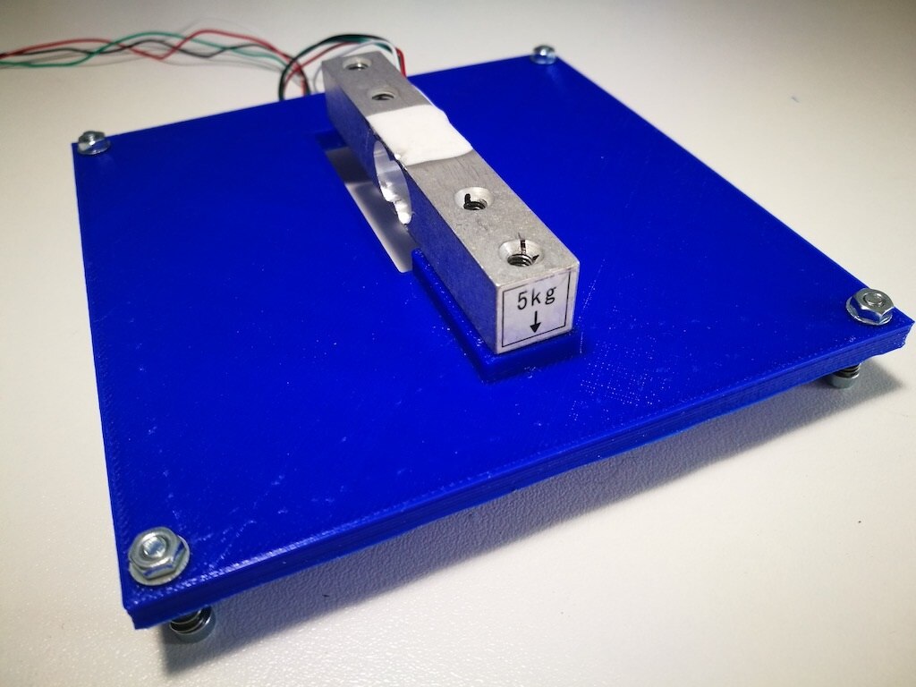

The base with the four calibration screws, top view
The base with the four calibration screws, bottom view
Calibration screw with spring of the base

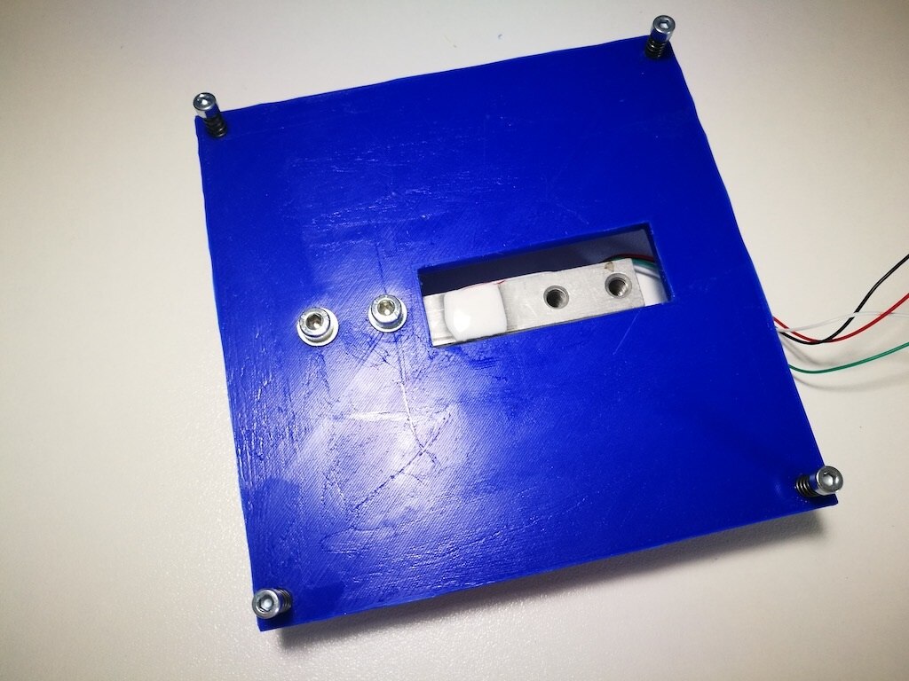

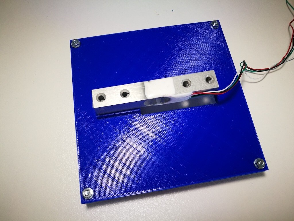

The base with the load sensor mounted, bottom view
The base with the load sensor mounted, top view
Base and load sensor assembled

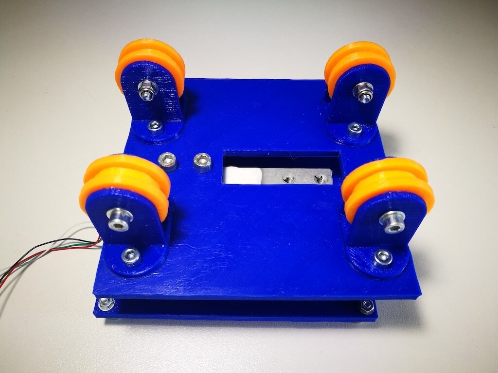

The top support mounted on the base through the load sensor
The final assembly side view

Testing the first version of the 3D printed scale I saw that filament rolls can have different spool dimensions, also if the same weight. To manage the different widths between spools (may depends on different providers or different production batches) the top base design has been update; now it is possible to set the position of the four free wheels supports as shown in the images below.
The wires coming from the load sensor are very thin and delicate so I decided that it was too risky to add a connector do I decided to include in the scale building also the HX711 filter adding two holes to the bottom part to fix the small IC board.

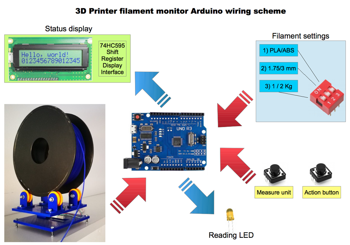

The image below shows the functional design of the circuit and the interface
As the filament is usually available in two different dimensions, 1.75 and 3 mm diameter, the rolls are available in different weights and we should consider using at least two kinds of materials it was necessary to provide a three dip switch to select these three settings before starting the system. Making the first experiments I saw tat it was impossible to distinguish automatically the three phases when a 3D print job starts:
1. Power the system and initialise it (calculating the empty tare without the filament)
2. Place the filament roll and wait the weight stabilises
3. Start reading the usage (material load)
(consumption can be expressed in grams or centimeters)

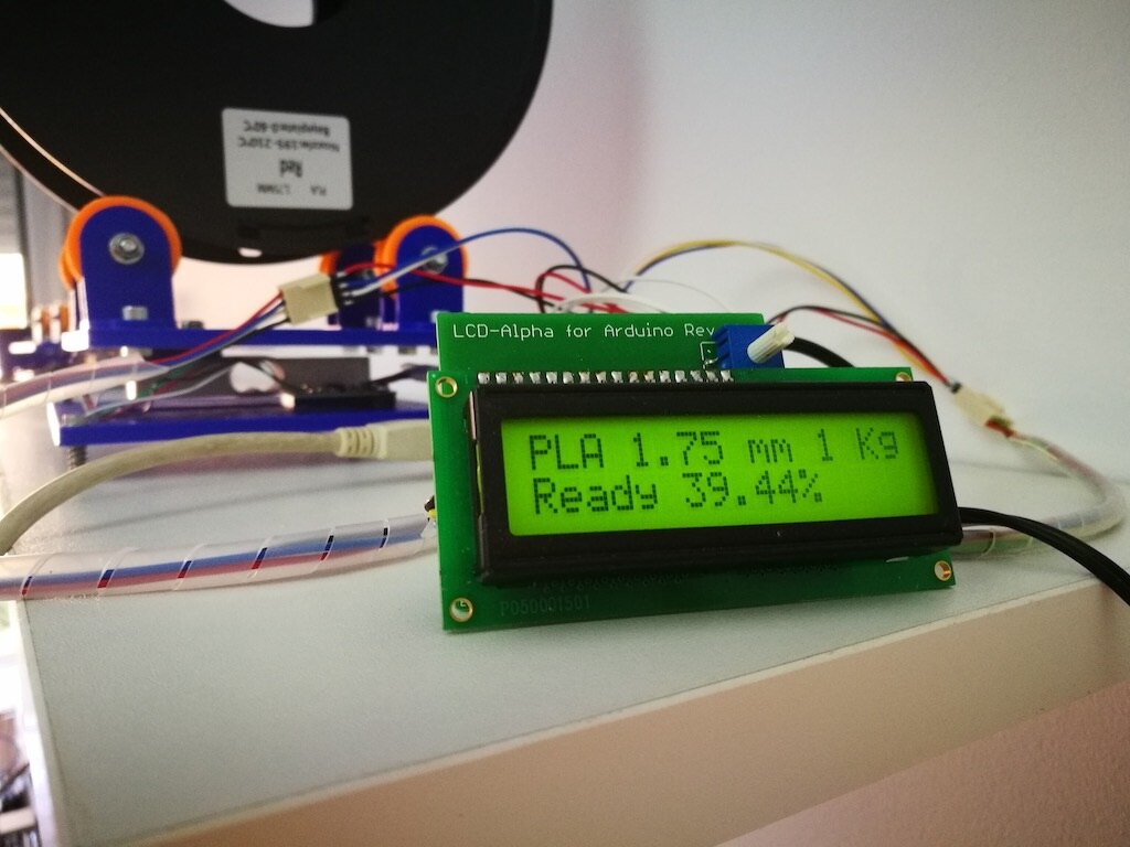

I have added two push buttons; an action button to manually set the three phases and a measure unit switch to select the visualisation on the display: filament units in grams or in centimeters/meters.
To have a complete status of the hardware a 3mm orange LED blink during every weight reading cycle while for the display I have used a shift register display (the full documented project is in these two articles: Enrico Miglino on ElectroSchematics.com  and Arduino 16x2 LCD Shift Register Library - Part 2 ) based on 74HC595 shift-in register I have built in past to reduce the usage of Arduino pins.
As the MC711 already generates a digital signal only two pins are needed to connect it to the Arduino board.

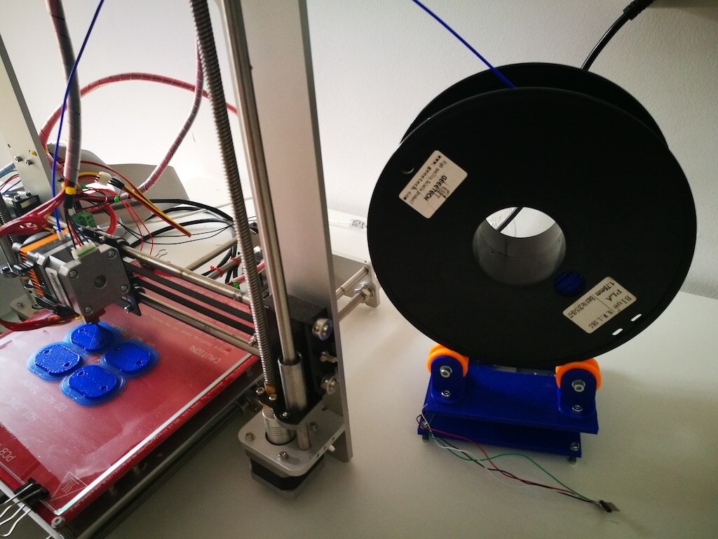

The project in action

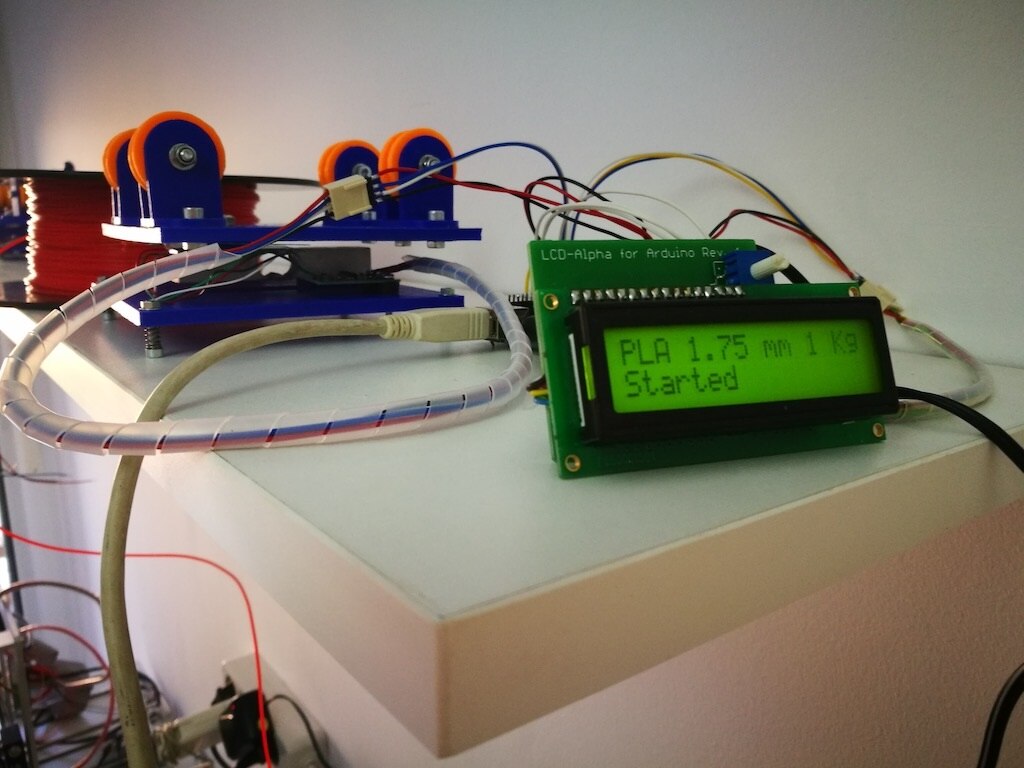

The video below shows the first prototype and the final building in action after software filtering calculations have been included in the building.
The initial part of the video shows how connecting the sensor only without controls, due to unpredictable weight fluctuations it is almost impossible to control the three phases mentioned above while the second part shows the final version accordingly with the wiring scheme.

  • michaelkellett
    michaelkellett over 9 years ago +3
    Nice to see the complete thing and I'm very happy that the load cell works out OK. In commercial designs of load cell interfaces (for high speed weighing conveyors and in store scales) I've ended up with…
    balearicdynamics over 9 years ago in reply to michaelkellett +3
    Hi Michael! True, it is a good accelerometer and I don't apply any digital filter excluding the MX711 amplifier. But there is a reason: fluctuations are just the value-added of this stuff. The software…
  • michaelkellett
    michaelkellett over 9 years ago in reply to balearicdynamics +3
    Looks good - I like the idea of the noise as meta-data ! MK
