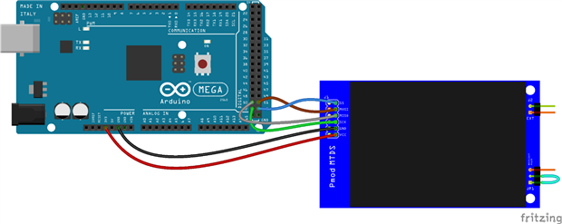

Interfacing Pmod MTDS with Arduino Mega
The Pmod MTDS communicates with Arduino Mega via SPI. However, the implementation of this physical interface is handled by the MTDS libraries, so the user doesn't have to directly use this protocol. The module is powered by 3.3V supplied by the Arduino Mega. The backlight of the display can also be powered from an external power supply, with the help of the J2 connector and the JP1 jumper. If an external power supply is used, it should be connected to J2 and the JP1 jumper should be put in the upper position. The pinout of the Pmod is presented in the following table:

To connect the Pmod to the Arduino Mega, connect:
  • VCC to 3V3
  • GND to GND
  • SCLK to 52 (SCK)
  • MISO to 50 (MISO)
  • MOSI to 51 (MOSI)
  • CS to 53 (SS)
Note: you can also find the Fritzing file containing the wiring diagram in the attachments.

  Wiring
  Pmod <----------> Arduino
  VCC       to        3V3
  GND       to        GND
  SCK       to        52 (SCK)
  MISO      to        50 (MISO)
  MOSI      to        51 (MOSI)
  CS        to        53 (SS)

Note: you can also find the Arduino sketch in the attachments.
Results
Pmod MTDS in use:
