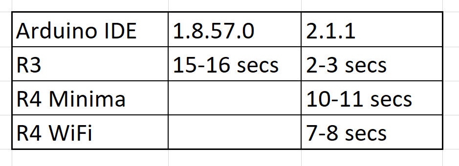

    dougw over 2 years ago in reply to fmilburn
    My demo display program takes anywhere from 17 to 21s to compile for Minima and anywhere from 16 to 36s to compile for WiFi. (1.8.15 IDE) These times vary by a several seconds when repeated.
  • baldengineer
    baldengineer over 2 years ago in reply to fmilburn
    I haven't timed the compile/upload times yet. But I was pleasantly surprised with how fast they were on the Minima compared to other 32-bit-based boards. Even the Blink with FreeRTOS example compiles very quickly.

    I did a quick test to see how quickly the R3, R4 Minima, and R4 WiFi compiled and uploaded.  I'm using the "blink" sketch and two different IDE versions without modification.  Here are the results:
    It isn't really what I expected.  The Arduino IDE version being used makes a huge difference with the R3.  It drops from around 15 seconds in the older version 1.8.57.0 down to something more than 2 seconds in the newer version 2.1.1.  I haven't used the Arduino IDE in quite some time and installed the latest version to test the R4.  Another surprise was that the WiFi version was faster than the Minima.  I'd be interested if others see the same thing or if I'm doing something off.
