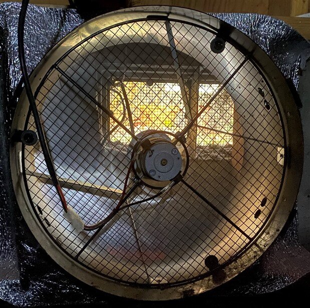

The crawlspace vent fan viewed from the crawlspace.

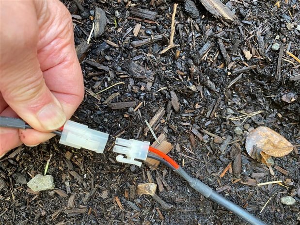

The power connectors are Molex Mini-Fit Jr, so I'm going to wire the controller using the same connectors.

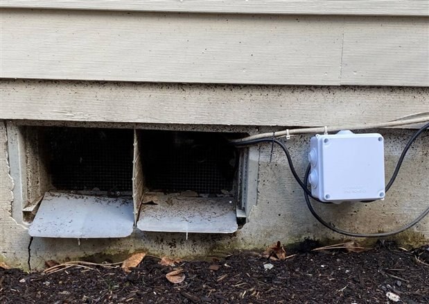

The vent from the exterior.  I found a weatherproof box that's shown on the right to house the electronics.  I'll probably mount it to the siding above the vent.  The cables above the box are for internet and telephone (not used anymore).

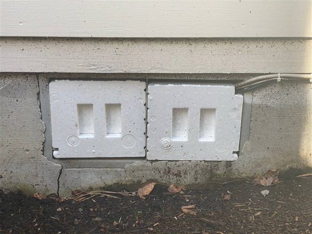

The styrofoam blocks used to weatherize the vent (of course, the fan has to be off).  I'm planning to put a set of louvers over the vent as part of the upgrade.

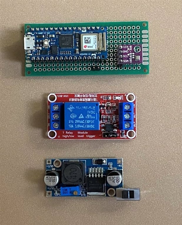

Here is a picture of the boards that I am using:
I've started to wire a proto board for the Arduino Nano 33 IoT - you can see the BME280 on the right.  The relay module is in the middle and the buck converter is at the bottom. I've also added a slide switch to the buck converter input to disconnect the solar panel voltage manually.
