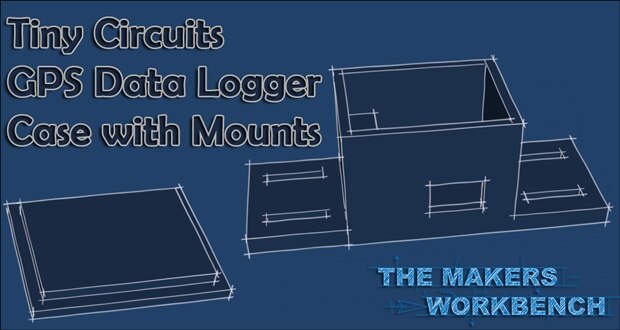

After a few days of research I settled on an Arduino and GPS shield combo with a cusom 3D printed case. Around the time I ordered the hardware I would need, a company called TinyCircuits contacted me and asked me if I would be interested in reviewing their products, and writing a few tutorials around their Tinyduino line of micro-development boards. I agreed and a few days later I had the company’s entire Tinyduino line sitting on my workbench.

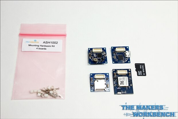

The GPS data logging project I found on Make.com was designed to track the author’s cat, but the code I needed to get my project off the ground would do the job whether it was tracking a cat or tracking the flight path of my quad copter. I realized that this project would be the perfect opportunity to write an article on how easy it is to build a project using the Arduino development environment and how easy it is to find, adapt and utilize existing code in your projects.
The TinyDuino series is pretty cool in the fact that you have a full Arduino Pro / Pro Mini packed onto a board the size of a quarter. I won’t go into great detail about the boards and what makes them so special, but if you would like further information on them, check out the full overview I wrote on TweakTown.com. Below is a list of everything you need to create a simple GPS Data Logger of your own using the Tiny Circuits hardware.
TinyCircuits PartsAlternate Arduino Parts From Newark
  • TinyDuino
  • TinyShield microSD
  • TinyShield GPS
  • TinyShield USB & ICP
  • TinyDuino Mounting Kit
  • 3D Printed Case
  • Code
  • Class 4 or higher 4GB microSD Card
Arduino Uno R3Arduino Uno R3
Arduino GPS ShieldArduino GPS Shield

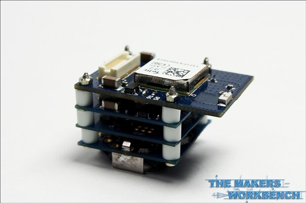

There really is not much to building the GPS Data Logger other than stacking the shields in the correct order, uploading the code to the Arduino, and then getting outside and logging some data. The stack should be built in the following order.  The bottom most board should be the TinyDuino, which should then be followed by the TinyShield microSD board. Up next would be the TinyShield GPS which is followed by the TinyShield USB and ICP.

I chose to power my GPS Logger using a 18650 powered USB cellphone charger instead of the CR2023 or JST methods that the TinyDuino also supports. If you chose to go this route, you will need to arrange your stack with the TinyShield USB & ICP board placed between the TinyDuino and TinyShield GPS, I chose this route because I had several spare USB cellphone chargers laying around.

With everything stacked together, let’s prepare the TinyDuino for coding. Plug a microUSB cable into the TinyShield USB & ICP board, then select the appropriate USB port that the TinyDuino is now connected to. Once the correct port has been selected, we need to set the Arduino IDE to recognize the correct Arduino-compatible board. Since we are using a TinyDuino, we need to select Arduino Pro or Pro Mini (3.3V, 8MHz) w/ ATmega328. Once finished we should be ready to import some test code to the TinyDuino to test that everything is working correctly.
Before we upload any code we will need to make a minor change to the SoftwareSerial library in the Arduino IDE. You will need to replace the SoftwareSerial.cpp and SoftwareSerial.h Library files with the ones found in the GitHub repo for this tutorial. Replacing the files is quite easy and you simply need to navigate to Arduino>libraries>SoftwareSerial and rename the existing files to SoftwareSerial_cpp.bak and SoftwareSerial_h.bak and then download the new files into this directory.
Now that that is complete, lets upload some test code to make sure that everything was configured correctly and the TinyShield GPS module is sending raw NMEA data to the Tiny Duino. Upload the code that is embedded below (also found in the Git repo titled GPS_Test_Firmware.ino) and then open the serial terminal in Arduino and set the baud rate to 9600. You should see some weird strings that look like the pasted code below the GPS Test Firmware code.

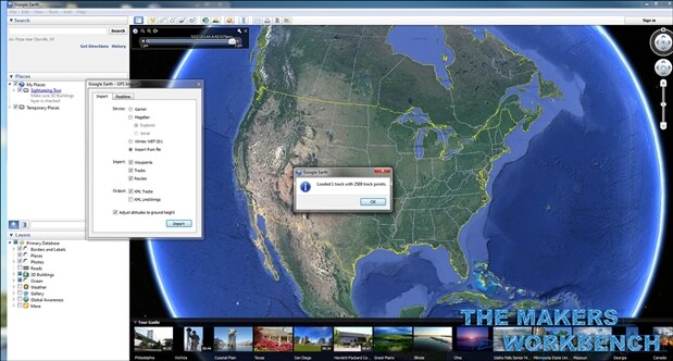

When you are finished recording data, head to your nearest PC and open the SD card to view the filed stored inside. If you correctly formatted the SD card then you should only see one file that is titled gps.txt. Make sure you have extensions visible if using Windows, and then rename the file to gps.nmea. The current SD library can only write extensions up to three characters in length and is why the file is saved as a .txt instead of nmea.
Once you have the file renamed, open Google Earth and navigate to Tools>GPS and click GPS. There will be an option to upload a gps file. You can simply browse to the gps.nmea file you renamed, upload that file and Google Earth will plot the exact path that your GPS Logger took when it was gathering data. There are several other programs that can be used to visualize this data, but I will not list them here as a simple Google Search will give you pages of information on them.
Now that we have the GPS Data Logger working, we need to secure the stack together using the TinyDuino Mounting Kit. This will ensure that the stack stays securely connected during any impacts that might occur during flight.
With everything secure, we also need to enclose the stack inside the case so that it is safe from static discharges, moisture, and debris. You can head over to Thingiverse , or Github to download the custom enclosure I designed to house this project. It is designed to be affixed to a quad copter or any other ½” surface using nothing but Velcro straps that are commonly used to bind computer cables together. It could also be secured using zipties as well.
