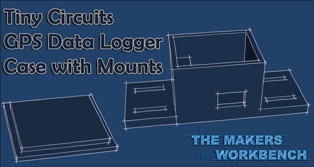

After a few days of research I settled on an Arduino and GPS shield combo with a cusom 3D printed case. Around the time I ordered the hardware I would need, a company called TinyCircuits contacted me and asked me if I would be interested in reviewing their products, and writing a few tutorials around their Tinyduino line of micro-development boards. I agreed and a few days later I had the company’s entire Tinyduino line sitting on my workbench.

Now that we have the GPS Data Logger working, we need to secure the stack together using the TinyDuino Mounting Kit. This will ensure that the stack stays securely connected during any impacts that might occur during flight.
With everything secure, we also need to enclose the stack inside the case so that it is safe from static discharges, moisture, and debris. You can head over to Thingiverse , or Github to download the custom enclosure I designed to house this project. It is designed to be affixed to a quad copter or any other ½” surface using nothing but Velcro straps that are commonly used to bind computer cables together. It could also be secured using zipties as well.
