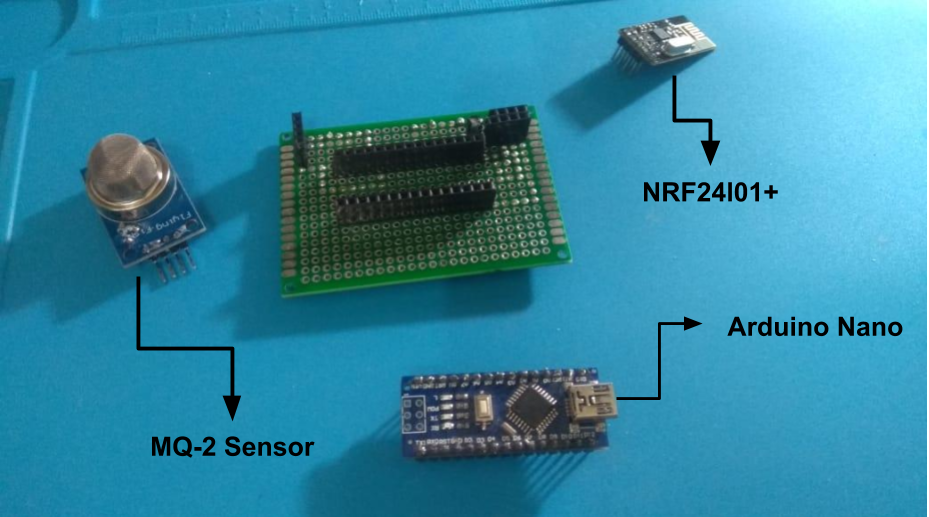

Smoke Node
To detect the environment changes, we created two types of Forest nodes, the first type of node has based  in the presence of smoke on environment. In this node, the microcontroller is able to detect changes in air quality and send an alert message to the gateway when the smoke level reaches a critical value for the environment. The smoke detector node is basically composed of an Arduino Nano, which will be responsible for monitoring the environment during specific time intervals. In addition, it also consists of a NRF24l01, a low-cost radio capable of operating at 2.4 Ghz frequency. And finally, we use an MQ-2 sensor to detect the amount of smoke condensed in the air.
Smoke node components.

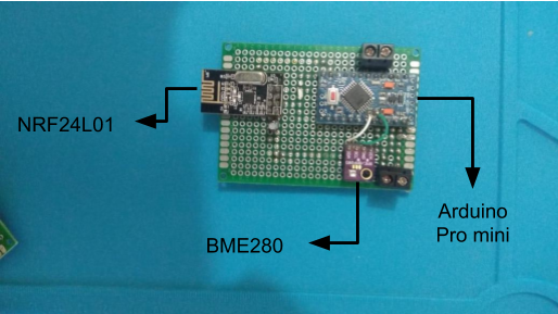

Temperature Node
The second type of node elaborated for this project, consists of the temperature node, this sensor node is able to detect variations in temperature and inform the gateway when a sudden change of temperature occurs in the environment. This node is composed of an Arduino Pro mini, which will be responsible for detecting the variation of temperature in the environment, a nrf24l01 +, for communication with gateway and neighbor nodes, and a BME280 sensor, a temperature sensor of high precision and low energy consumption .
imageTemperature node components.

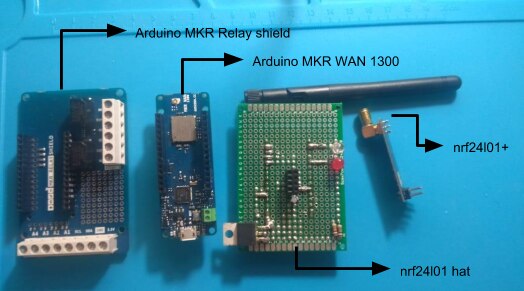

Gateway Node
To route the sensor network data to final user, we need a microcontroller able of transmit this data for a long distance. In this case, the LoRa protocol will be ideal due to its long reach and low power consumption. With this, we will use the Arduino MKR WAN 1300 which has a long range chip. However we will need to establish communication with the network nodes to obtain the data. With this we will build one hat (Hardware at top) to facilitate the connection between Arduino and NRF24l01.
                                             Gateway Components.                                                                                                                                       Gateway Assembly.

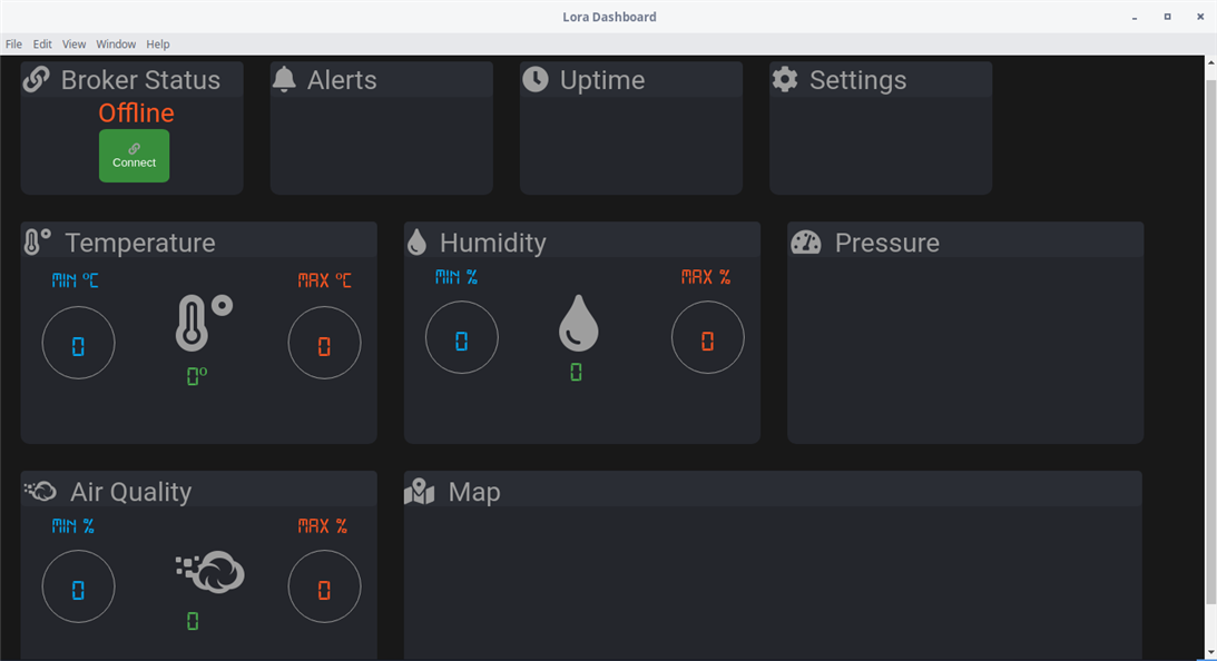

The Dashboard
To provide informations about the forest under monitoring,  we build a dashboard using Electron framework where the user can get informations about temperature, alerts about a region, humidity, pressure and the air quality based in data provided by forest sensors. To receive the data from sensor network, you will need to use two Arduino MKR WAN 1300, when one will be connected using serial in computer running these dashboard, and the other node will works like gateway, providing a bridge between user and low cost network.

  • frenchsimmer
    frenchsimmer over 7 years ago +2
    It's a very interesting concept indeed. I suppose that it will be solar powered ? Did you plan to connect the different sensors to an AI system ? Look forward to see the developmement of your project …
    genebren over 7 years ago +1
    Interesting concept. Are you considering power sources? It might be nice to be able to use solar cells to avoid needing to change batteries. There seems to be a lot of ideas on how to monitor conditions…
