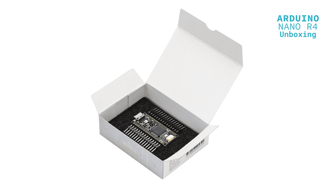

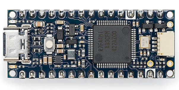

1. Unboxing & First Impressions
The Arduino Nano R4 was received in standard Arduino packaging with the board securely enclosed in an anti-static cover.
Package Contents:
  • Arduino Nano R4 board
  • Berg strip headers (unsoldered)
Initial Observations:
  • Compact Nano form factor retained
  • High-quality PCB finish
  • Clearly labeled pinout
  • USB Type-C interface for modern connectivity
The inclusion of unsoldered headers allows flexibility depending on application (breadboard vs embedded use).

Observed Symptoms:
  • X No COM port visible in Arduino IDE
  • X Device shown as “Unknown USB Device” in Windows Device Manager
  • X Upload attempts failed completely
  • X No LED indication of bootloader activity
Point right At this stage, the board appeared non-functional and inaccessible

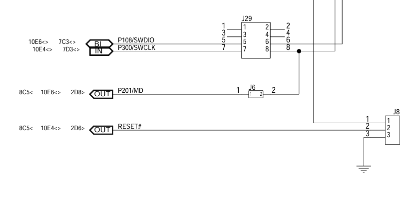

11. Switching over to SWD debug access to recover the target chip R7FA4M1AB3CFM mounted on Arduino Nano R4 board:
Now, i would like to refer to official schematics of Arduino Nano R4 given on this link:
https://docs.arduino.cc/resources/schematics/ABX00142-schematics.pdf

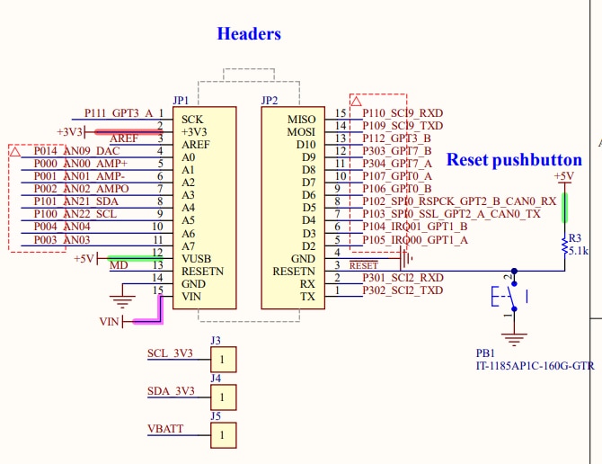

Here are 3 important observations about above picture are given below required for SWD bebug access:
1. MD pin of MCU given on JP1 connector pin no 13. -> This pin should be connected with SWCLK pin of debugger.
2. RESET pin of MCU given on JP2 connector pin no 3. -> This pin should be connected with RESET pin of debugger.
3. VUSB pin of MCU given on JP1 connector pin no 12 -> This pin should be given +5VDC from debugger USB power supply.
Here are some important observations about above picture are given below required for SWD bebug access:

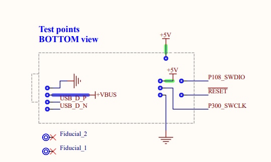

1. P108_SWDIO & P300_SWCLK are required to connected with any compatible debugger -> Jlink / CMSIS-DAP / Renesas made Emulator
2. Very-very important point :  P300_SWCLK & MD pin of MCU given on JP1 connector pin no 13 should be shorted with each other & connected to SWCLK line from debugger side.

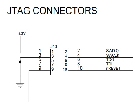

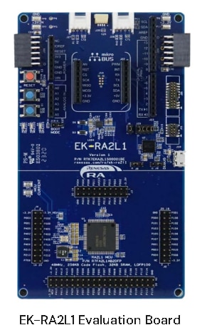

Again by chance, i already possess this evaluation kit made by renesas:
This board already have onboard Jlink OB lite debugger mounted on this kit. So, i decided to connect this debugger to Arduino Nano r4 while totally disconnecting on board target chip.
Now, referring to schematics of this kit which are found in ek-ra2l1-v1-designpackage.zip , these are important points everybody needs to consider for connections given below:
Please! download ek-ra2l1-v1-designpackage.zip from Renesas website.

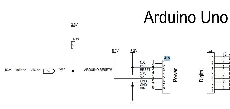

Now, given below is important section of debugger to get connected with external target chip
Important Note: all jumpers shown in this diagram needs to taken out totally, to cut off the onboard target chip for debugger connections.
J13 connector shown above is not populated in actual kit, so all the connector pads are exposed which were directly soldered for debugger connection with Arduino Nano r4 board.
In above picture, 5V power supply can be easily seen which was connected with Arduino Nano R4 board to get power up using debugger USB power supply.

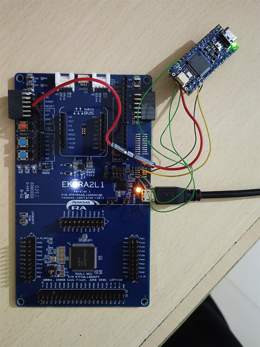

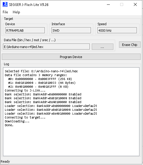

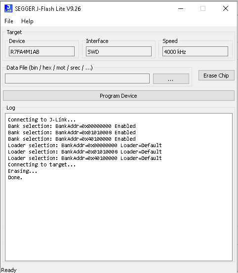

So, SEGGER J-FLASH LITE was able to program Arduino Nano r4 board successfully, below picture demonstrates that:
So, SEGGER J-FLASH LITE was able to erase Arduino Nano r4 board successfully, below picture demonstrates that:
Important point: I have tested the Renesas Flash programmer in exactly same fashion, but that was not working correctly at all.
I m showing the picture of actual physical connections with debugger & Arduino Nano R4 board given below:
Important observation noted: I was able to recover original preloaded program which was actually loaded in Arduino Nano R4 at time of arrival using jlink debugger.

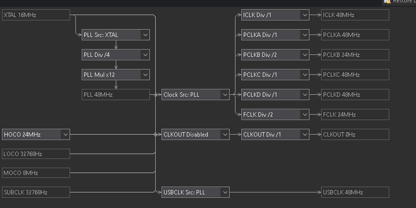

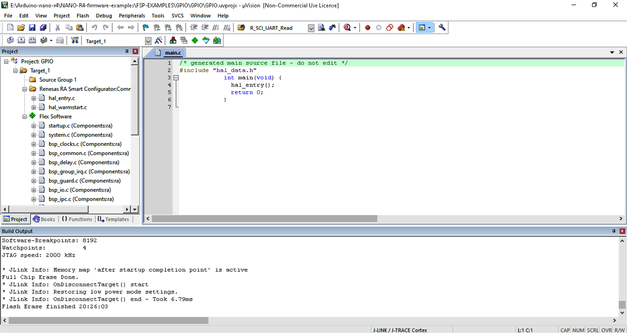

12. Switching over the development of  target chip R7FA4M1AB3CFM mounted on Arduino Nano R4 board from Arduino IDE into Keil MDK ARM :
Here you have to use Renesas smart configurator with Output configured for Keil MDK ARM.
select the clock settings given below in Renesas smart configurator in given screenshot:

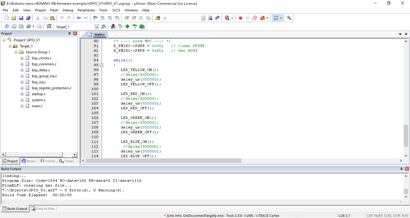

In bsp options, just select bare metal & No RTOS to include. Also select option to generate Blinky program in this configurator.
Below given picture demonstrates the output given by Renesas smart configurator for Keil MDK ARM:
To run this program correctly, Please! do the following steps:
Search & comment  this line given below:
FSP_HARDWARE_REGISTER_WAIT(R_RTC->RCR2_b.RESET, 0);   -> This line is found in bsp_clocks.c
Important observation: Debugger gets stuck on above line.

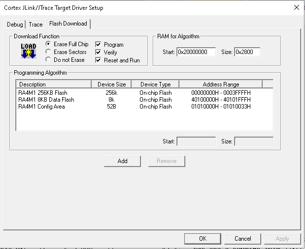

Configure the below settings in Flash download of keil as shown screenshot given below:
Apply the above settings, then follow the below given steps:
Generate the hex file.
Completely erase the chip.
Then program the chip using download button in keil.
Expected result: You should be able to RGB LED as single white LED glowing brightly but without blinking.
