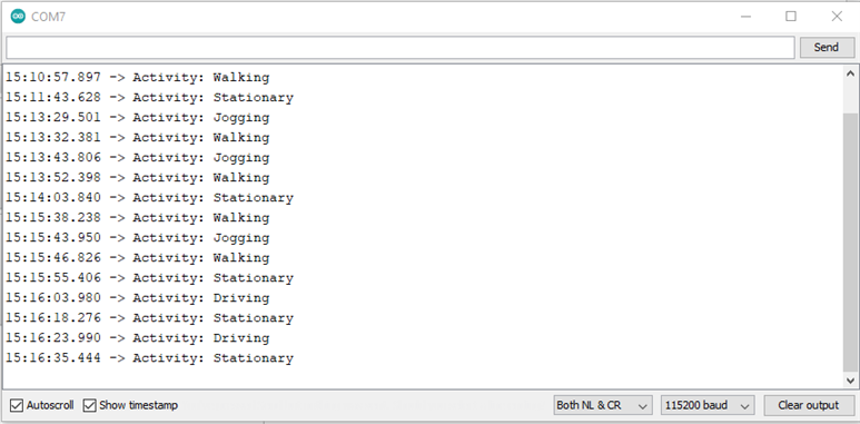

On to try the demo .https://docs.arduino.cc/tutorials/nano-rp2040-connect/rp2040-imu-advanced
The demo is built using the Arduino IDE and uses the STM32duino X-NUCLEO-IKS01A3 library ("LSM6DSOXSensor.h") and the library example X_NUCLEO_IKS01A3_LSM6DSOX_MLC.ino.
There is a pre-built model file that is included "lsm6dsox_activity_recognition_for_mobile.h".
The only required change to the example program is to specify the correct interrupt pin for the Nano RP2040 Connect:
#define INT_1 INT_IMU
Nano_RP2040_Connect_LSM6DSOX_MLC.ino

  SerialPort.println("Program loaded inside the LSM6DSOX MLC");
  //Interrupts.
  pinMode(INT_1, INPUT);
  attachInterrupt(INT_1, INT1Event_cb, RISING);
  /* We need to wait for a time window before having the first MLC status */
  delay(3000);
  AccGyr.Get_MLC_Output(mlc_out);
  printMLCStatus(mlc_out[0]);

The program has 6 output classes:
  1. Stationary
  2. Walking
  3. Jogging
  4. Biking
  5. Driving
  6. Unknown
I found that being tethered by the USB cable made it difficult to do a real test.  I could get it to detect Stationary by setting the board on the table, but when I tried to hold it stationary I would sometimes detect Driving.  Must be the old age jitters.  I could get Walking with a slow or moderate up-down motion and Jogging with a faster motion.  I could not figure out what type of motion would get it to detect Biking.  I guess if I added a battery and a display, I could take it out for a real test.  Here's some of the output that I obtained.
I was trying to do a video demo, but I think I had a resource issue with the video capture program and crashed the computer - even had to do a recovery of my C drive image.
Here's what I captured before the crash.  I got to the point of trying to get it to register "Jogging".  I think you can get the sense of the flow, so I'll skip trying to do it again.
I came across an interesting article that Qeexo, a TinyML platform developer, is collaborating with STMicro to create models for the MLC sensors using AutoML  https://www.prweb.com/releases/qeexo_collaborates_with_st_to_automate_machine_learning_on_machine_learning_core_mlc_sens… .
The platform seems more focused on commercial applications, but hopefully they'll see value in offering a free "Community" edition.  Having an online platform to develop models will make this feature much more attractive.  I already have a project where this would reduce my hardware complexity and improve efficiency - if I could get sufficient accuracy...  I think this is a case where waiting for the technology to develop makes sense.  Maybe other ML SaaS companies will pick this up.

  • javagoza
    javagoza over 5 years ago in reply to vlasov01
    You can poll each of the 8 dedicated Machine Learning Core registers: MLC0_SRC (70h) through MLC7_SRC (77h) as needed to continuously check the decision tree outputs.
    For this example
    STMems_Machine_Learning_Core/application_examples/lsm6dsox/Activity recognition for mobile at master · STMicroelectronics/STMems_Machine_Learning_Core · GitHub
    Just poll MLC0_SRC (70h) register for changes
    MLC0_SRC (70h) register values
    0 = Stationary
    1 = Walking
    4 = Jogging
    8 = Biking
    12 = Driving
