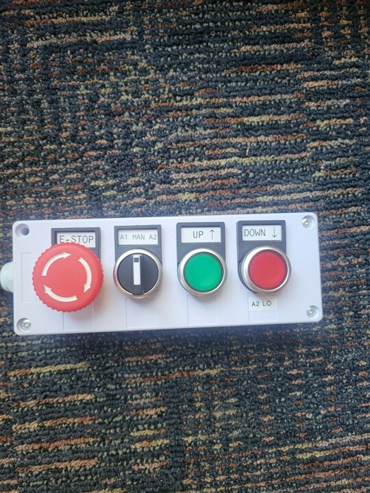

Automatic cat door with Arduino interface and PLC
This project is not entirely Arduino, but I think it is a good example of how Arduino's can be incorporated into other systems. The initial design of this project was to automatically open and close the cat door and track the cat's activity also control when the cat can go in or out. The PLC was chosen for the main I/O and stepper motor controls because of its robustness and the Arduino was chosen for the cat counting activity process. The system features three main modes of operation which is 1 - manual up down, 2 - automatic up down, 3 - in only. The up and down operations can be controlled by a pendant station or RF remote and IP website controls. For the stepper motor and linear rail safety for the cat there is a proximity sensor in the cat door to detect anything in the door and stopping operations also the linkage from the linear rail to the door has been designed so if anything closes onto a cat or anything else in the door will not shut. There are four sensors on the door, two low sensors (inside/outside) to detect the cat and two high sensors (inside/outside) to detect humans and prevent the cat door from opening necessarily. The Arduino cat counting is basically for detection if the cat is currently outside or inside by reading even or odd numbers there will be more updates to this system in the future.
I have included all the documentation at the bottom for your reference.

INPUTS		D2-16ND3-2		Slot 0
PLC Card	Wire#	Ref	Function	Part Type	Connection
CA	W10100	-24V	Comm		CA
0	W10101	MPB-1	Run/Stop	PENDENT E-Stop SW	12
1	W10102	SS1-2	Mode Auto 1	PENDENT 3 Pos SW	14
2	W10103	SS1-3	Mode Auto 2	PENDENT 3 Pos SW	24
3	W10104	PB1	UP PB-Green	PENDENT PB	24
4	W10105	PB2	DN PB-Red	PENDENT PB	24
5	W10106	RF/IP	UP	DASH LILGO/RF REMOTE	K1-NO/A1-NO
6	W10107	RF/IP	DN	DASH LILGO/RF REMOTE	K2-NO/A2-NO
7	W10108	LSW1	UP Limit	MICRO SW	NC
CB	W10200	-24V	Comm		CB
0	W10201	LSW2	DN Limit	MICRO SW	NC
1	W10202	PX1	Cat In Door	Taiss M18 Prox	BK
2	W10203	POD-1	Cat Inside	AM312 PIR	K-1-C
3	W10204	POD-2	Cat Outside	AM312 PIR	K-2-C
4	W10205	POD-3	Human Inside	AM312 PIR	K-3-C
5	W10206	POD-4	Human Ouside	AM312 PIR	K-4-C
6	W10207	MRSW-1	Door open	MRSW	NC
7	W10208	PCD1	Light Level	Photo Cell	17
OUTPUTS		D2-08TR		Slot1
0	W10301	SMC01	Stop	ZK-SMC01_Controller	0
1	W10302	SMC01	REV-UP-CCW	ZK-SMC01_Controller	1
2	W10303	SMC01	FOR-DN-CW	ZK-SMC01_Controller	2
3
4
5
6
7
C		SMC01	COMM	ZK-SMC01_Controller	BLACK
OUTPUTS		D2-08TR		Slot2
0	W10505	ENA+	Enable	SMD1	Screw 2
1
2
3
4
5
6
7
C
ZK-SMC01 DIP Settings			RF Remote Control Jumper Settings
SW1	On	4.9A	PIN 1	PIN 2	PIN 3
SW2	Off	4.9A
SW3	Off	4.9A	No Jumpers	No Jumpers	No Jumpers
SW4	Off	1/2 Curr
SW5	On	800
SW6	Off	800
SW7	On	800
SW8	On	800
PART LIST
No	Ref	MFG	Model No	Part Type	Cost
	MPB-1	TWTADE	hz-11ZS-20X-GR	PENDENT E-Stop SW	$26.98
	SS1	TWTADE	hz-11ZS-20X-GR	PENDENT 3 Pos SW
	PB1	TWTADE	hz-11ZS-20X-GR	PENDENT PB
	PB2	TWTADE	hz-11ZS-20X-GR	PENDENT PB
	RF	Unknown	Unknown	RF REMOTE
	IP	DASH LILGO	T-Relay ESP32	IP REMOTE
	LSW1	WWZMDiB	V-156-1C25	MICRO SW
	LSW2	WWZMDiB	V-156-1C25	MICRO SW
	PX1	Taiss	E3F-DS30P1	Proximity SW
	MRSW-1	Unknown	Unknown	MAGNETIC REED SW
	PHO
	TB#	GUETNEU		Terminal Block
	POD-1	PCE	AM312	PIR Ampifler
	POD-2	PCE	AM312	PIR Ampifler
	POD-3	PCE	AM312	PIR Ampifler
	POD-4	PCE	AM312	PIR Ampifler
	PS	Koyo	D2-04B	PLC Card
	CPU	Koyo	D2-230 CPU	PLC Card
	Input	Koyo	D2-16ND3-2	PLC Card
	Output	Koyo	D2-08TR	PLC Card
			ZM-SMC01	Stepper Cotroller
			DM556	Stepper Motor Driver
	PS1	Sola	SDN 2.5-24-100P	24VDC Power Supply
	PS2	PCE	LM7812c	24V to 12V Power Supply
