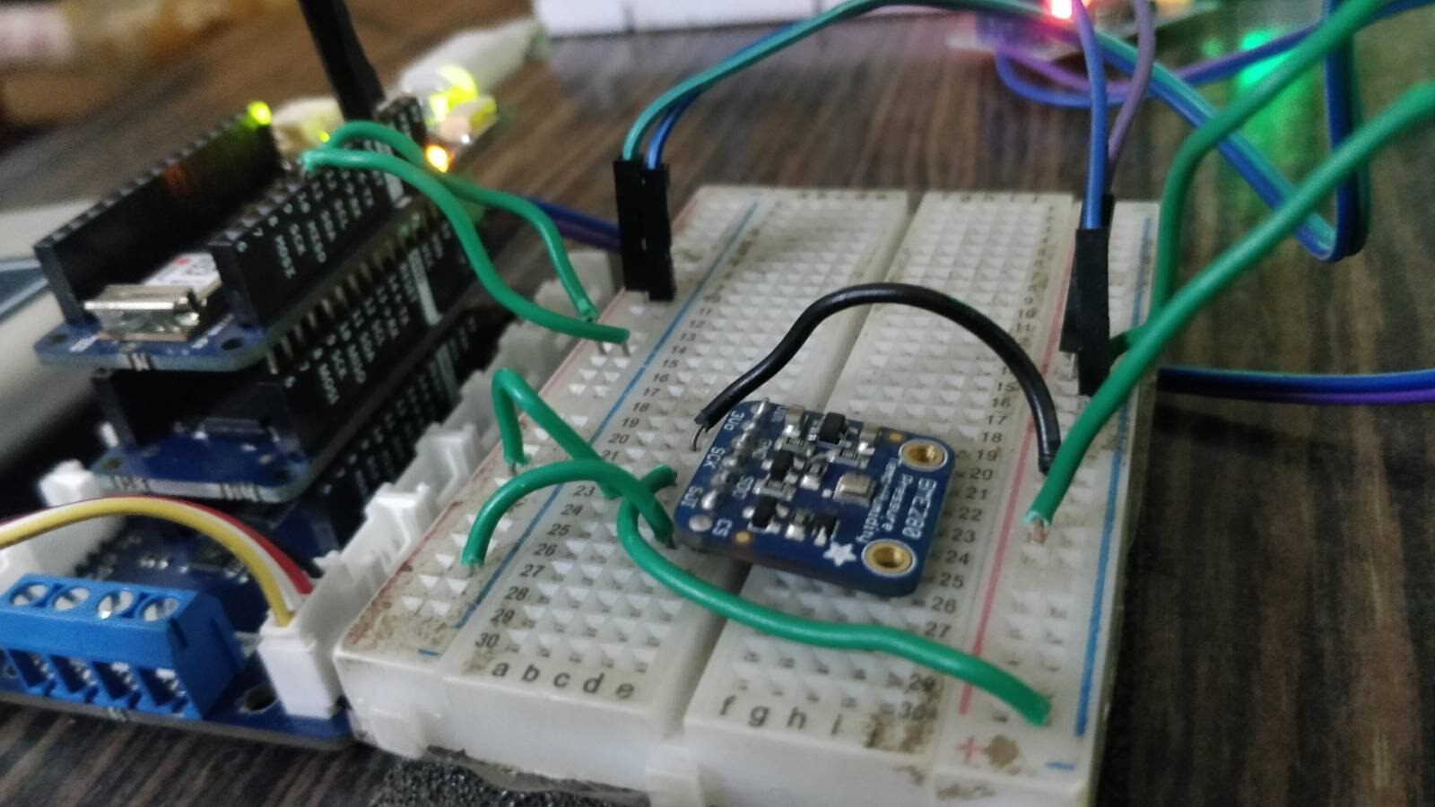

  • BME280 // i2c sensor to detect temperature, humidity and air pressure

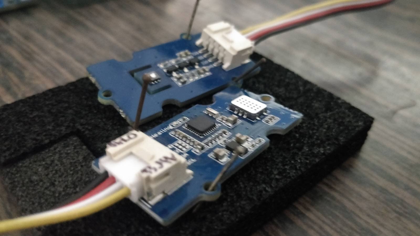

  • Grove eCO2 and VOC sensor // for some gases
  • Grove Multichannel Gas Sensor // for some gases

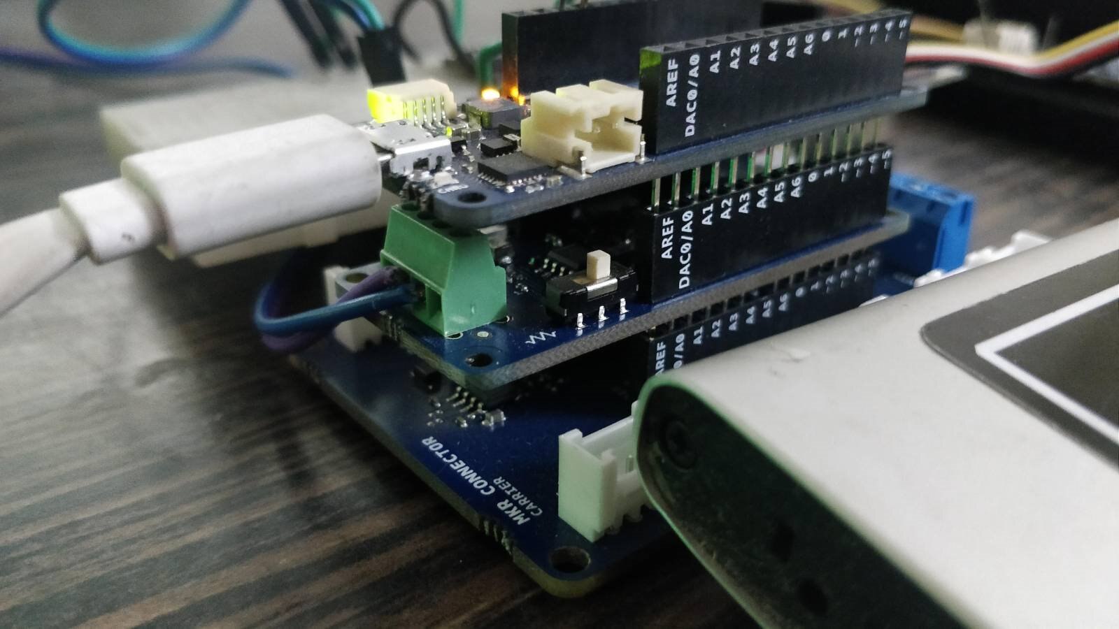

  • MKR Connector Carrier // for less dirty wiring

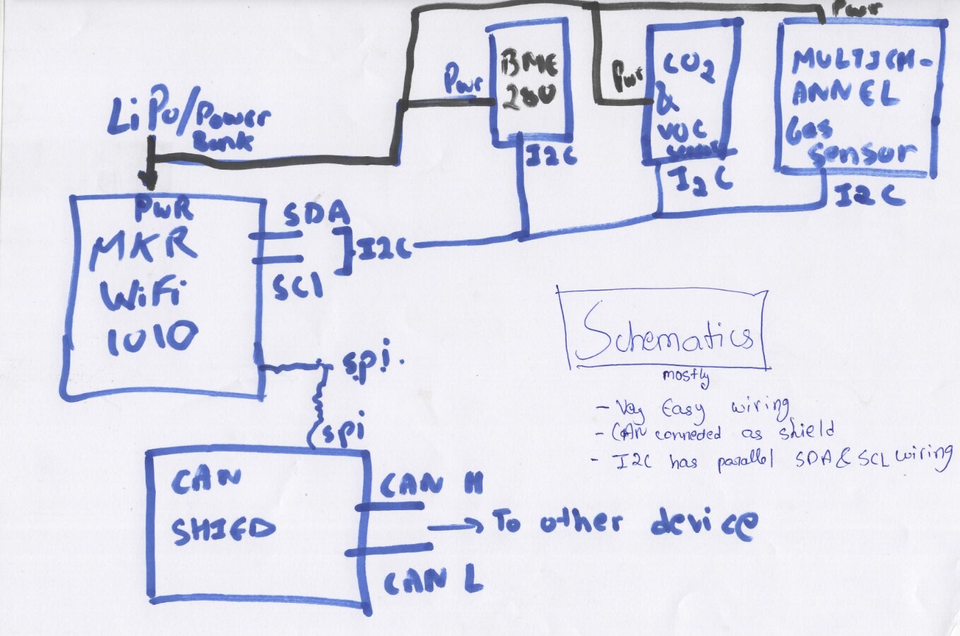

Schematic/ Wiring:
All the Wiring is pretty simple, nothing like biological science!

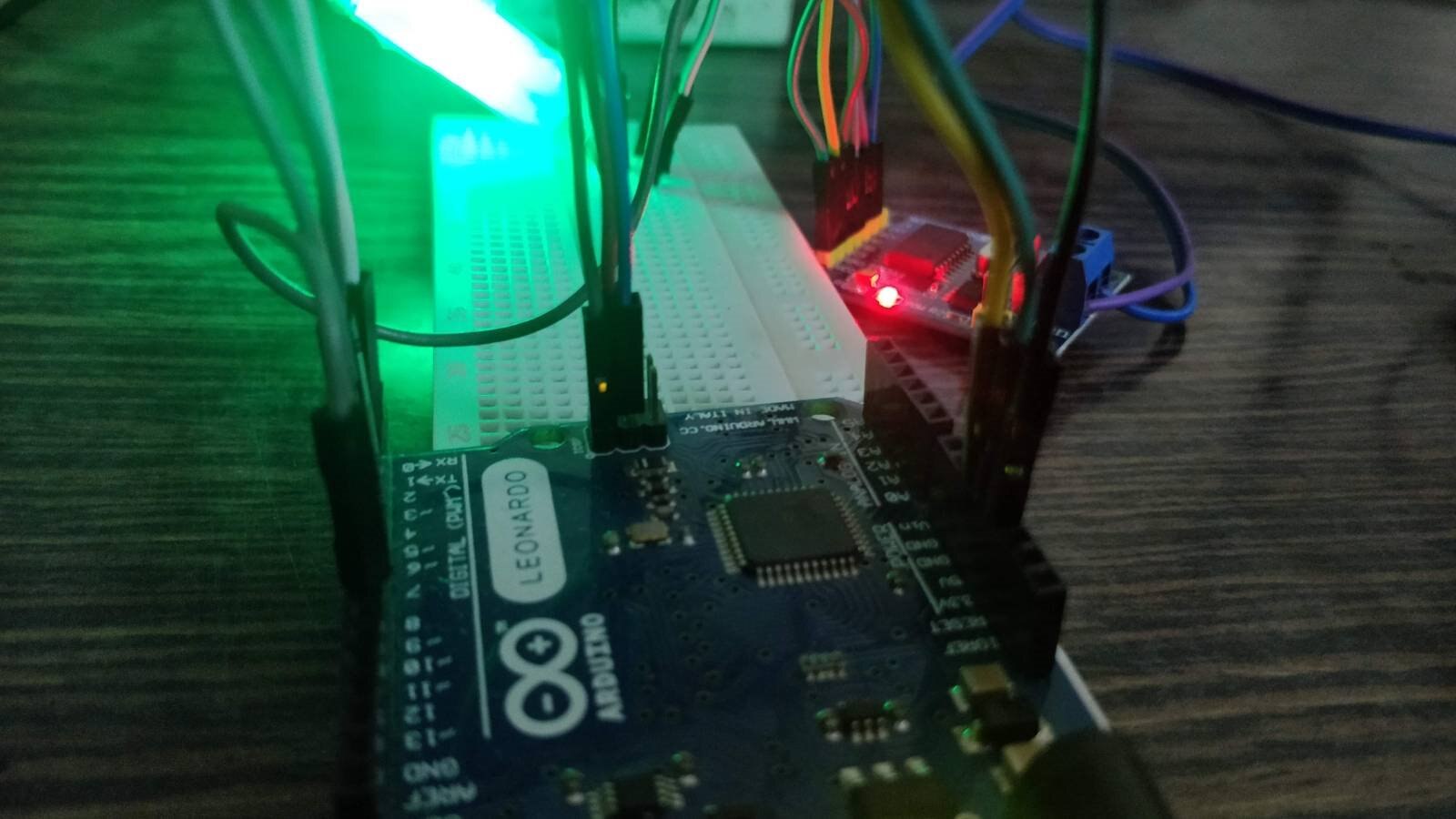

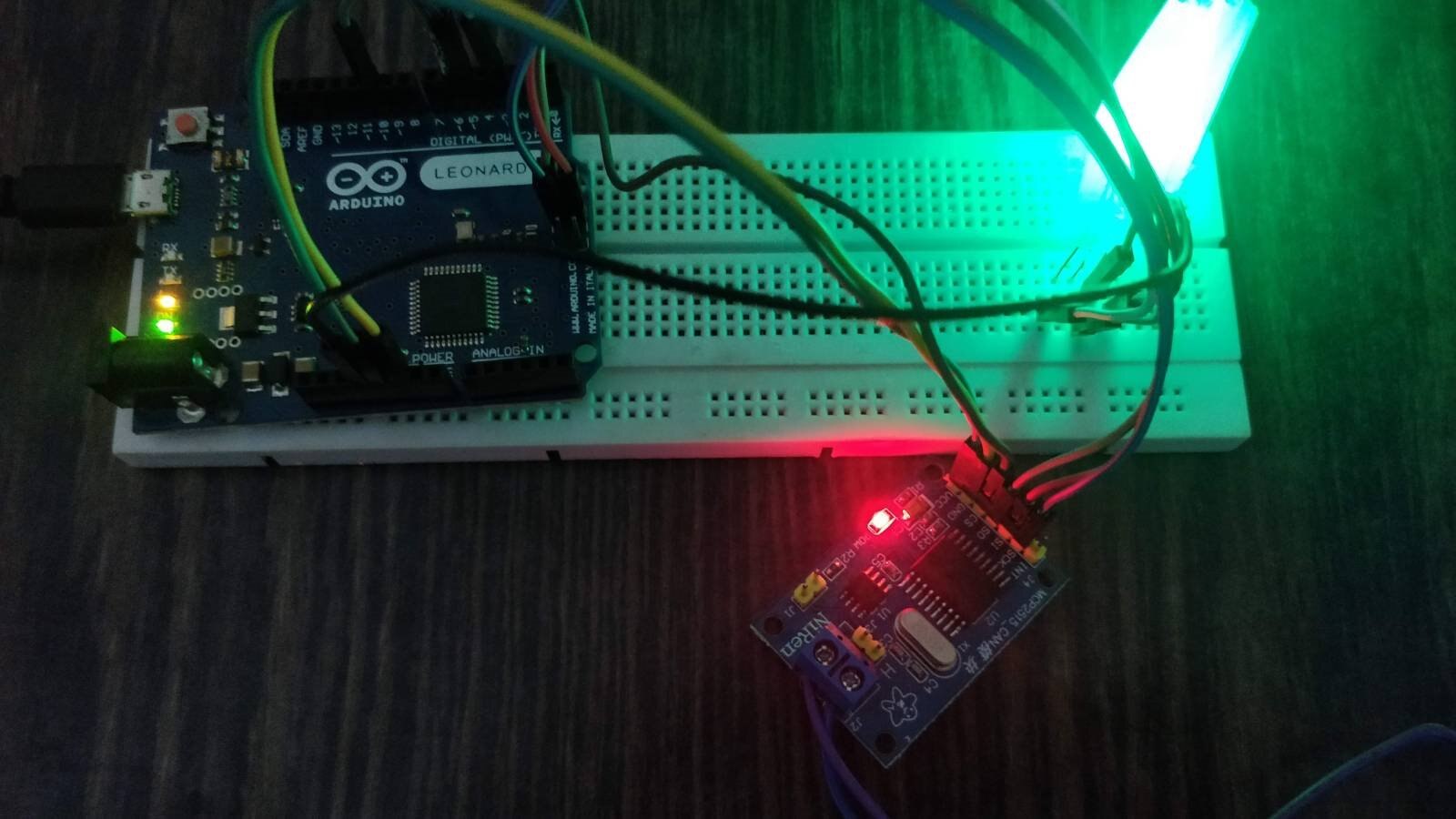

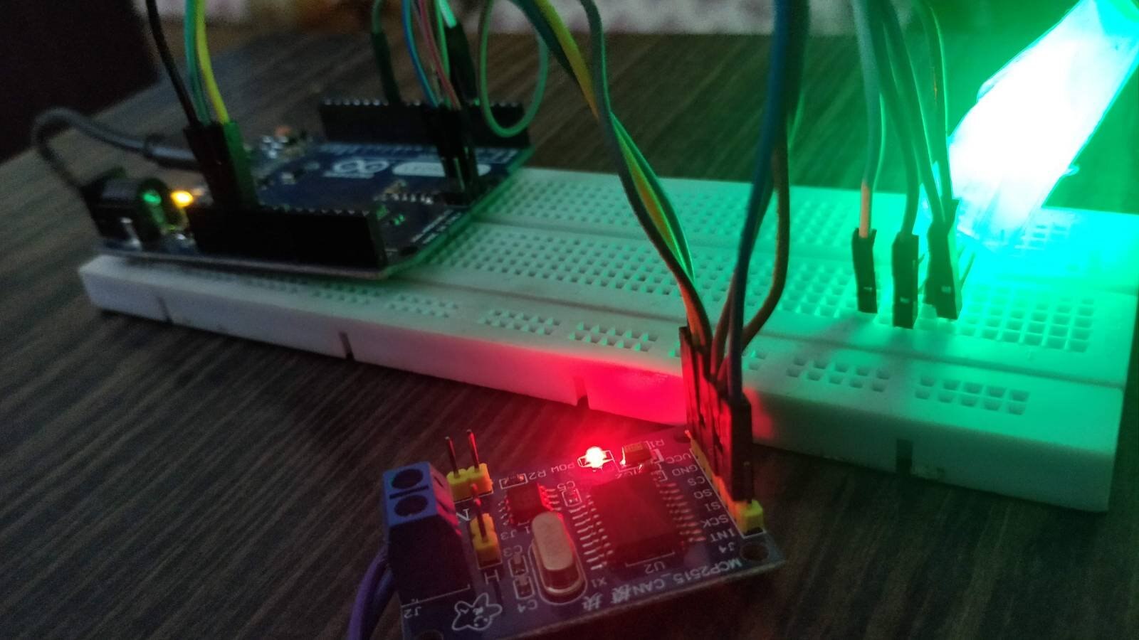

About the CAN device:
For a consumer use, I could not get any CAN device to hack upon, ofcource I cannot mod a real car, so I made my own little CAN device, with another CAN mosule (MCP2515) connected via SPI, a FAN (motor) , some Alert LEDs, and another Arduino(Leonardo) , which works great. It has its own commands which I sent from my project.
Microchip MCP2515 wiring
Microchip MCP2515Arduino
VCC5V
GNDGND
SCKSCK
SOMISO
SIMOSI
CS10
INT2
CS and INT pins can be changed by using CAN.setPins(cs, irq). INT pin is optional, it is only needed for receive callback mode. If INT pin is used, it must be interrupt capable via attachInterrupt(...). The code is on my GitHub Repo
The CAN device arrangement.

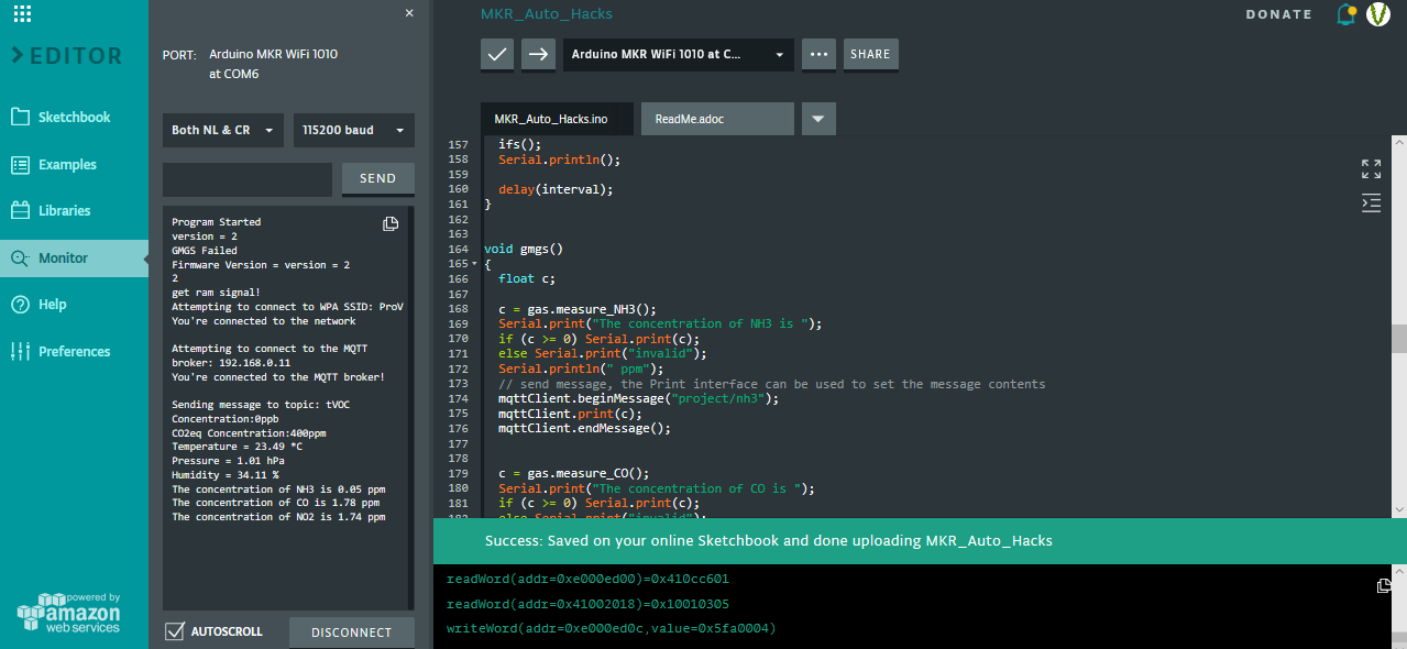

     Note: All MKR Boards are having some issues for me in working with the offline editor. Its baud rate and an unusual MKR <board> package not found error. Even after removing and installing the latest and the previos build thrice it did not work, even on different computer. But the online Editor works very well and I used that to code for this project.
     The Online Editor in actionimage

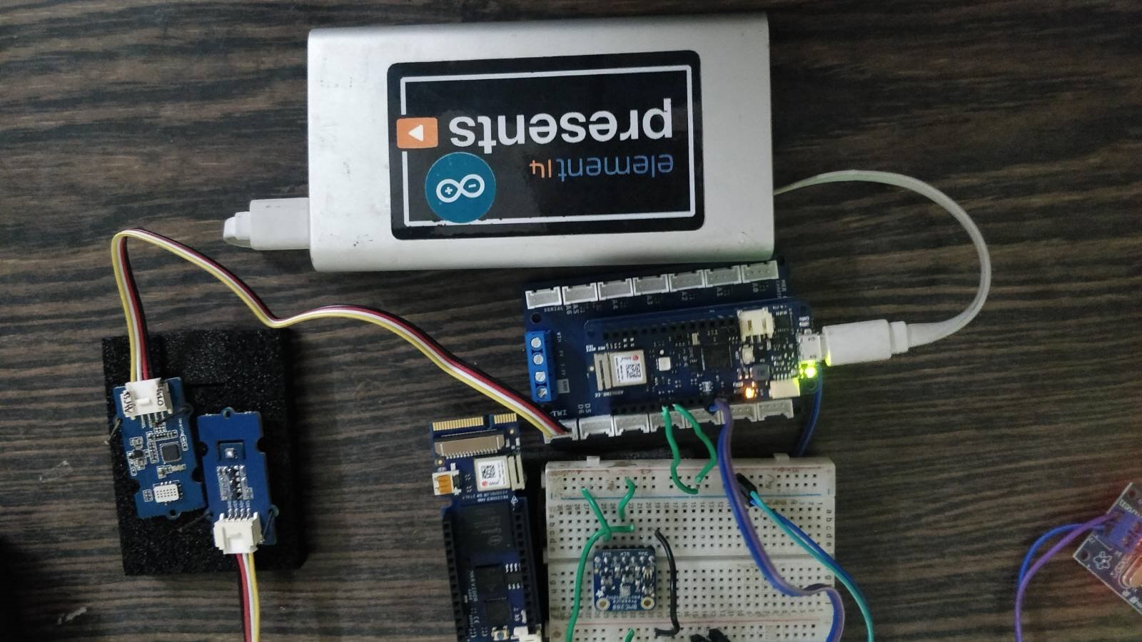

After Connecting all the things: MKR WiFi 1010, CAN shield and Grove Connector Carrier stacked with some wires for sensors and CAN and supply.

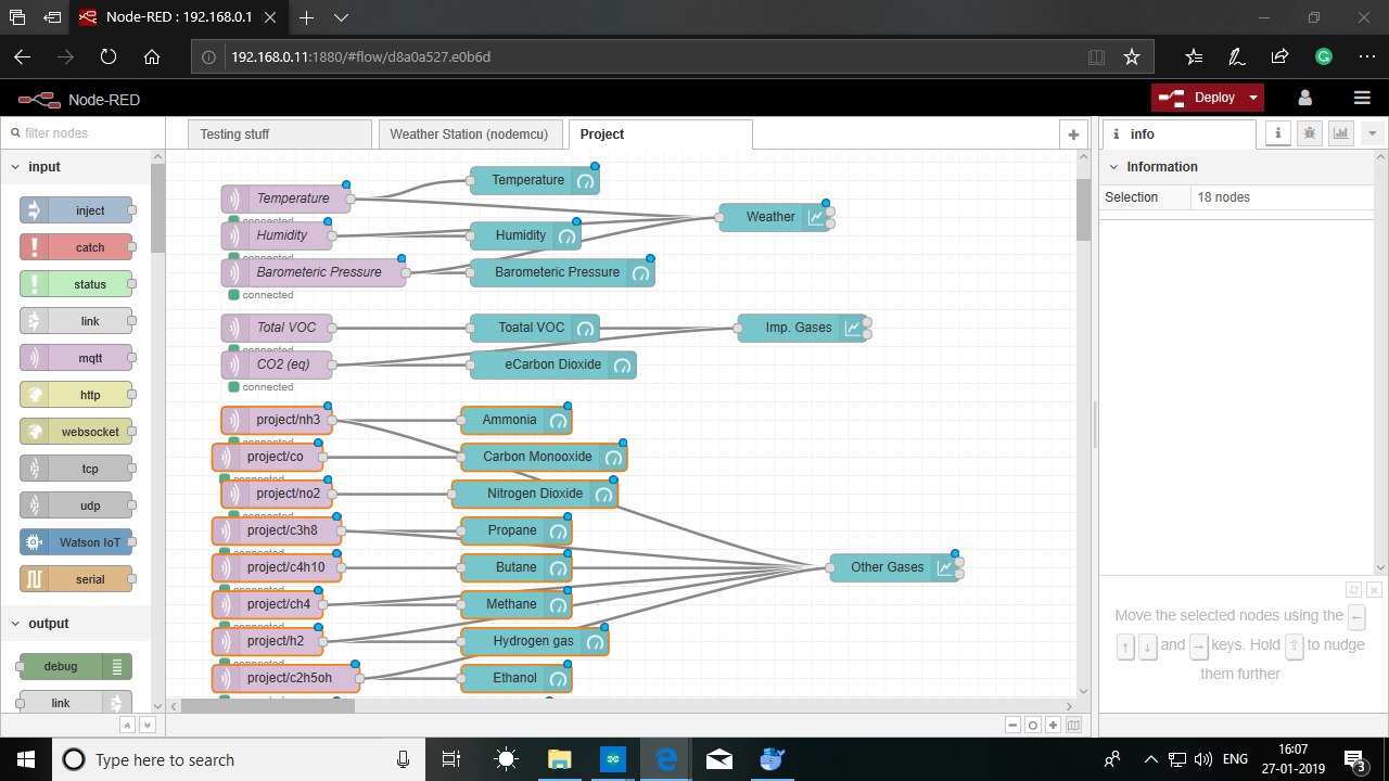

For the server side, I used my RPi Zero W and setup Mosquitto MQTT and Node-Red on it. Node-Red is a node JS based GUI for drag and drop commands and works really well for creating stuff quickly. I created a very simple Block code, for this purpose. You can though use any IOT service like Blynk or even Adafruit IO MQTT with some changes in code. The Import Sippet for Node-Red can be found in GitHub Repo.

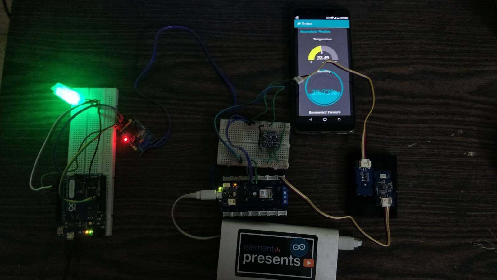

View of my "Nodes"image

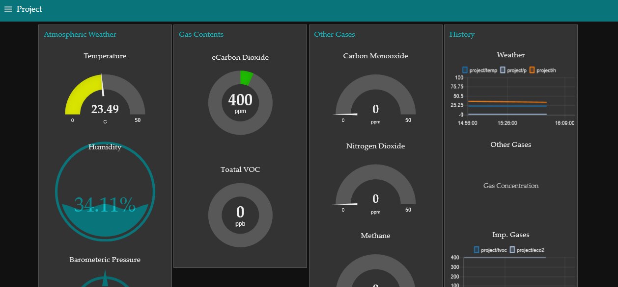

My Dashboard View.image

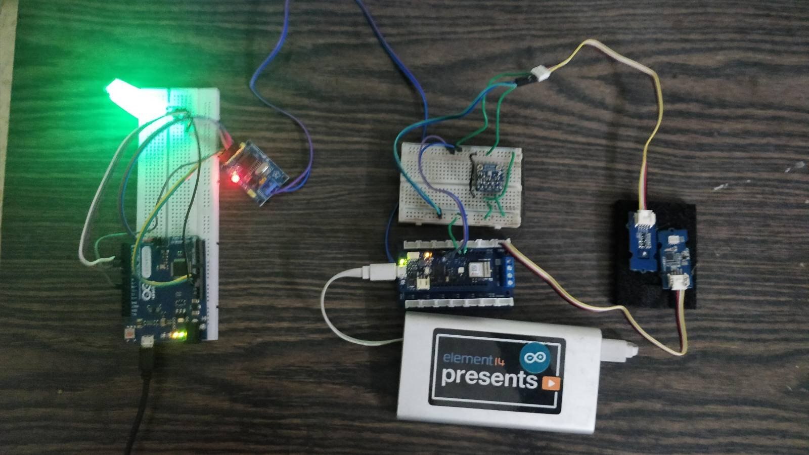

The Final Product:
This is my Final Arrangement with all things connected. (not a permenent setup but a working one)

There is a major problem while using the Grove multichannel Gas Sensor and that is it takes a lot of time in heating up, even on 5V rail, this causes the MQTT gateway to shutdown ,while measuring the values. Althought this problem is only observed when the room temperature is quite cold. It dod notwork for me in my home when temps were around 20C. But it works outside, in sunlight and in warm areas (most industries have warm emperatures after all) or heated rooms.

    Very cool project. You have a nice mix of IoT related tools between MQTT, Node-RED and Cloud service. The use of the Arduino Create Editor is interesting. Is that Dashboard from Arduino Create or from…

  • jomoenginer
    jomoenginer over 7 years ago
    Very cool project.  You have a nice mix of IoT related tools between MQTT, Node-RED and Cloud service.  The use of the Arduino Create Editor is interesting.   Is that Dashboard from Arduino Create or from something else?
