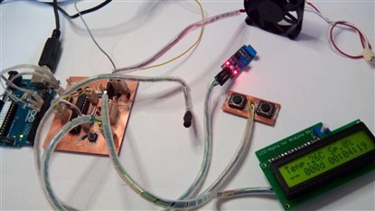

The following video shows the main features of the work on the testing bench.
The components
The system consists of the control board and a set of accessories processing external data, plus the connection with the controlled system if needed.
LCD display
The 16x2 alphanumeric LCD display continuously monitor the system health status by default: temperature, fan percentage speed, up-time in hrs, min, sec. When an alarm condition occur (shock risk or overheating) the display shows the alarm condition. The display is also used to show message feedback to the user interaction.
Temperature sensor
The temperature sensor is based on the IC LM35. The internal calculations for the read values have one decimal C precision while the display only shows integer values. By default the maximum temperature working value without overheating risk is 60C and the minimum temperature value to start the fan (10% of the max speed) is 30C. These values can be set as well, depending on the environment where the board is used and where the sensor is positioned.
Vibration sensor
The vibration sensor sensitivity can be regulated with the trimmer on the board; the regulation should be done to trim the vibration alarm in different conditions depending on the environment where it is installed. The sensor generates a digital signal every received vibration in the sensitivity range.
By default the board firmware react to the first detected vibration generating a shock risk warning on the display. If the  vibrations continue for five seconds the warning become an alarm; then the board can automatically power off the controlled device.
Cooler fan
The cooler fan is controlled as direct feedback by the temperature sensor. Depending on the instant detected temperature with a resolution of about 0.5C the fan speed is updated between 10% and 100% or 0% (stopped when the temperature is under the minimum of the configured range). The fine tuning of the fan response to the temperature depends on the respective position of the sensor and the fan, the size of the environment where the control board is installed and the heating of the system when it is running. The control board can support different fan sizes working at a voltage between 6 and 24V. The Fan power VCC is separated by the control board power.
Note: the fan speed control uses the PWM but works with cheap fan devices without the PWM control line; the shown used model is a 12V fan motor with two power cables only.
User programmable buttons
The two user programmable buttons can be associated to any action of the controller. Typically the two buttons can be used for reset and power on/off where the action on the controlled board is managed by the controller, for example sending a long press for power-on or a press sequence to reach certain results.
Programmable digital output signals
The board provide two digital output signals. These can be used to simulate a button-press or a button-sequence. The two signals are amplified by a couple of  2N2222 acting as switch The signals can also be connected to a 5V coil relais to manage higher currents
Separate power lines
The board is provided with two separate power lines: a 5V to power the board (can be replaced by the Arduino board while programming the micro controller) and a power line for the cooler fan.

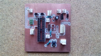

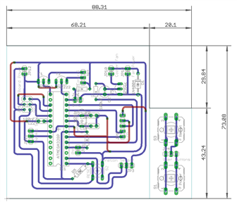

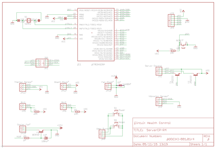

Schematics and layout
The two images below shows the circuit schematics and the PCB layout.

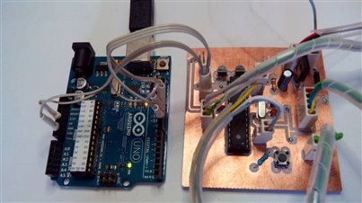

... and the board on the test bench connected to the Arduino ISP programmer

    BTW, what did you route the PCB with, it seems to have done an OK job but is does also sem to avoid running between the pins of the 328 so perhaps not too fine on the resolution ??
